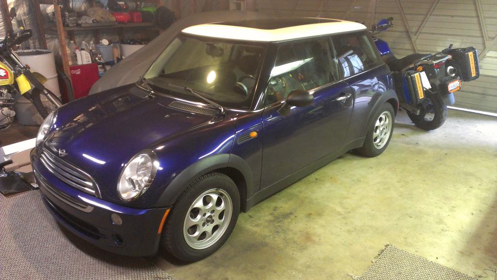

Got the airbox on the Mini out today to begin on cables. Upon closer inspection, the cables were actually in great shape, it was the shift selector. Like others have reported, the bushing in the connecting arm for the 1/2, 3/4, 5/R was very tight, and lube didn't help. I made a bushing with some steel tube I had, along with a properly sized bolt/nut and threadlock. It's MUCH smoother now, but still tight, and will suffice until I find/buy a new selector... any selections?

+1 on the cables to check, but it looks like the shifter lug. Just get the new selector, makes it easier.

Once I replenish the savings account, I'll be grabbing a new selector switch. however my McGayver fix seems to be working great for now!

Good find getting an 2005...the first year with the stronger more reliable getrag tranny....the midlands used from 2002-2004 has failures when driven hard!!
Realoem.com is a great site for skematics....
One tip...
BMW/mini does not stock/sell many parts...they expect you to just change the entire unit...
But one example is on the s tranny, folks found the ford focus svt used the same tranny...so we can get 6 speed parts when needed.....so on an s we can get the individual bushings for a couple cents...not sure what car the cooper tranny is shared with...but might be worth a few minutes of looking.
