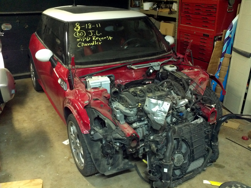

And, here is the sad picture.

Well, I'll try to post this photo.

Second, that is a VERY FIXABLE mini... you’ll need the front end sheetmetal wise, probably cooling and definitely radiator support.
Don’t try to buy a used front clip out of a junkyard, you’ll pay 2000-2600 bucks for one. If you could pick one up for about a grand, it would be worthwhile.
Easy fix... great find.

Call a salvage yard and get your airbag system. They will have a cross reference to tell you what will or won’t fit. I’m pretty sure any 2007-2010 will work, you may have to change steering wheels.
You can get a complete salvage srs system including control module, seatbelts, airbags, etc for waaaay less than half than new.
Airbags are either deployed or not. I wouldn’t think twice about using a used airbag setup. (HOWEVER, I would make sure I got the whole setup from ONE car, not an airbag from one, an srs control unit from another, etc, etc)
AND... one more thing. if you come across a deal with just one (driver’s or passengers) airbag (assuming you need both) don’t buy just one. You’ll have a hell of a time buying just one later.
HTH’s,

The reason I say that is most salvage yards won’t sell one out of two airbags. If they sell them, they’ll want to sell them in pairs.
If you want me call around for the suppliers that we use, I can call for you if you want.
