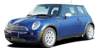

I'm getting the sense I should be getting better mpg on my '06 MC. I have an appointment at the dealer this Friday for inspection and I'll diffinitely have them check things out. At 31.5K I shouldn't need a tune-up. When did Gen2 begin?
