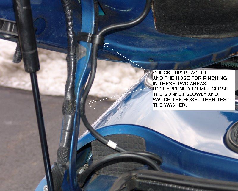

Open your bonnet and look on the left side of the engine compartment... make sure a black delivery hose isn't pinched. If it is, you'll block flow of the fluid to the jets. It's on the left as you look at the engine, BTW.
Do you hear the pump running when you call for fluid? That's probably it.

Here are a couple of photos I just took to illustrate better. My MINI is dirty!
Good luck.
