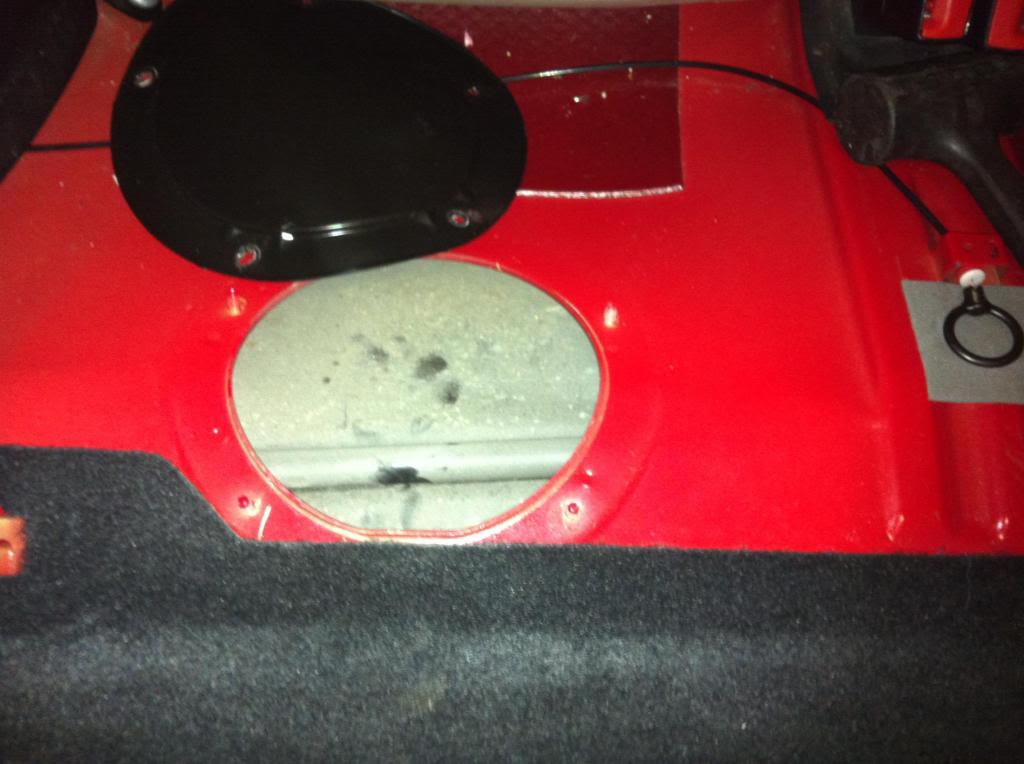

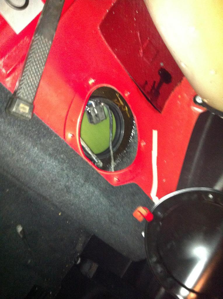

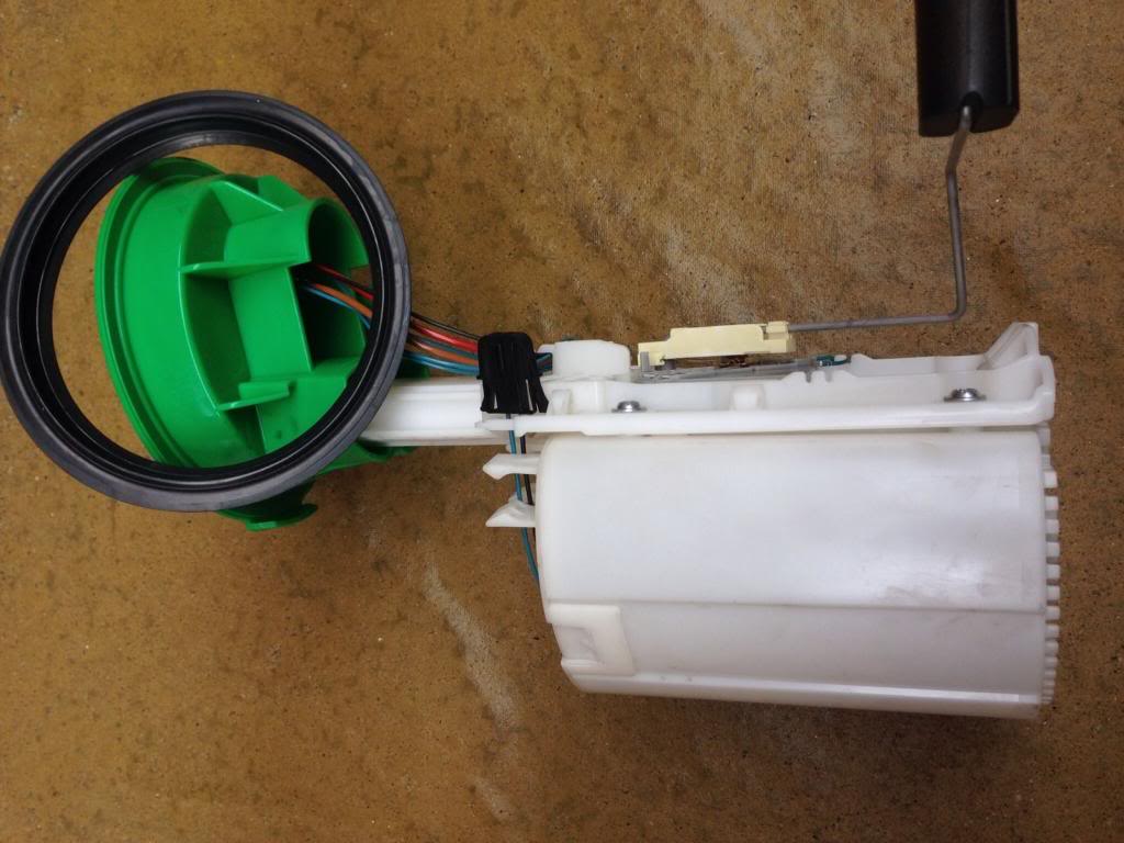

Hi folks decided to replace the fuel filter today due to my idle misfire issues on my 2007 cooper justa not S.........
When i removed the cover for the fuel filter and removed the housing ..............WTF....WTF..... LOL the fuel filter is missing or at least this housing doesn't have a filter installed this housing looks different from ones ive seen online....same with the other cover nothing under there either..........
Anybody shed any light on this.........

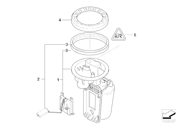

I am getting that sinking feeling that this could be the source of all my idle and bad running problems......has some f*ckin imbecille put the wrong fuel pump/sender into the car in this case a cooper S into a Justa ?......looking on ebay and real oem a 2007 r56 justa sender is supposed to look like this....also i noticed when i bought the car the fuel guage seemed to take forever to drop from full to half and once the fuel level dropped thats when the idle and eml light came on.....What The good suffering *****...lol this is gonna be fun if thats what it was all along lol

my car is a cooper 2007 according to real oem my tank has one hole and a pump/filter/sender all in once unit....the one i discovered in my car is from a CONVERTIBLE lol with no fuel filter enclosed......any wonder the damm car was running rough lol
