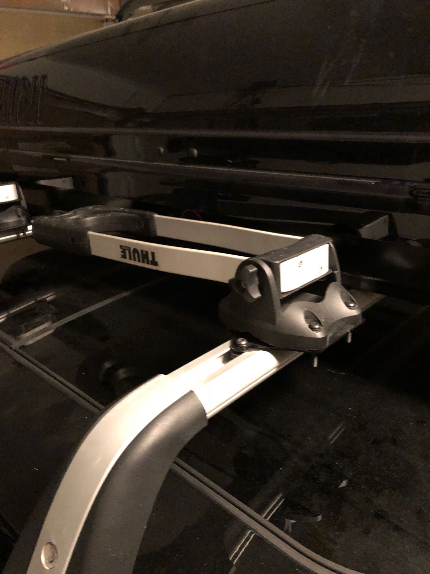

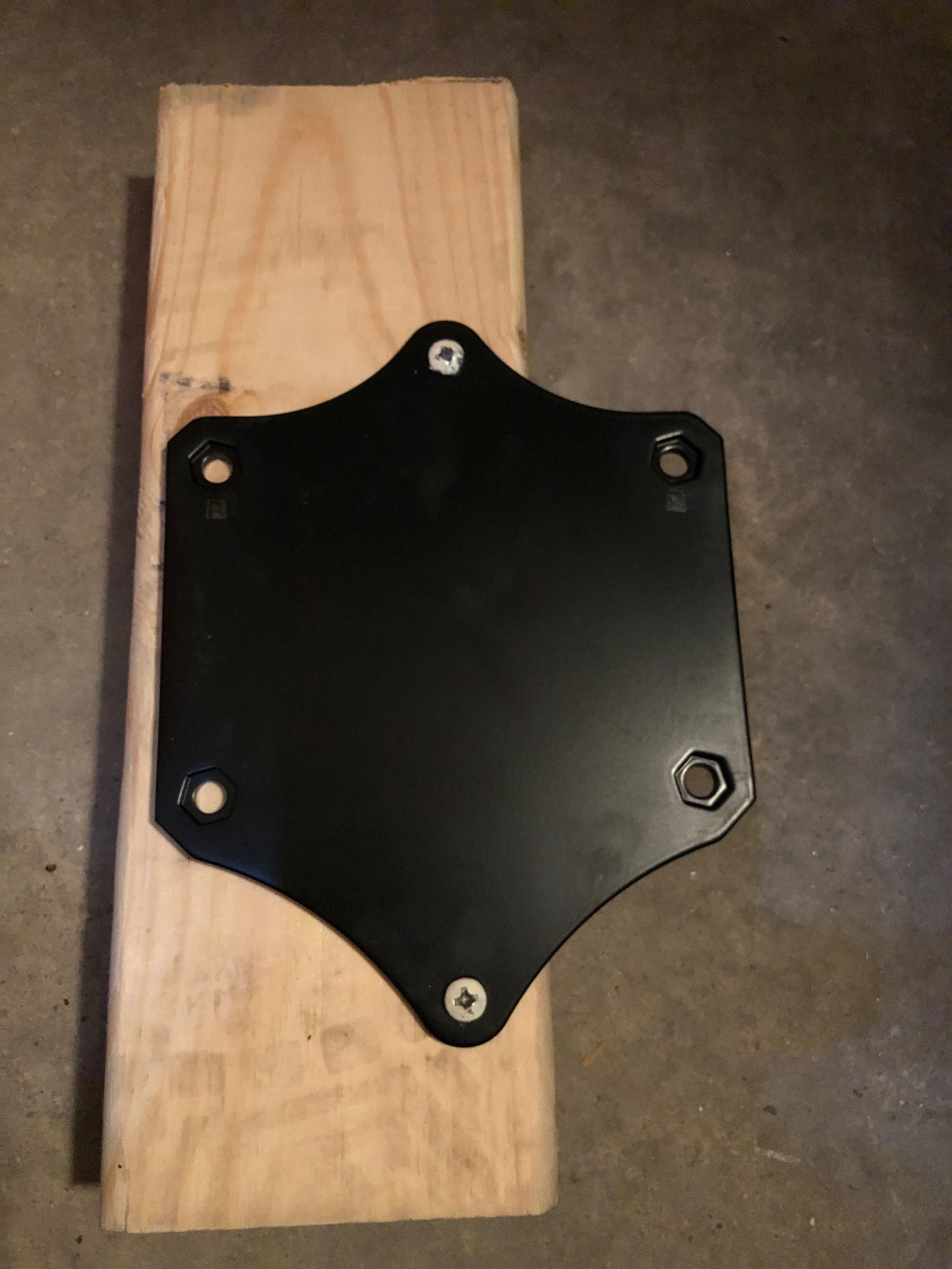

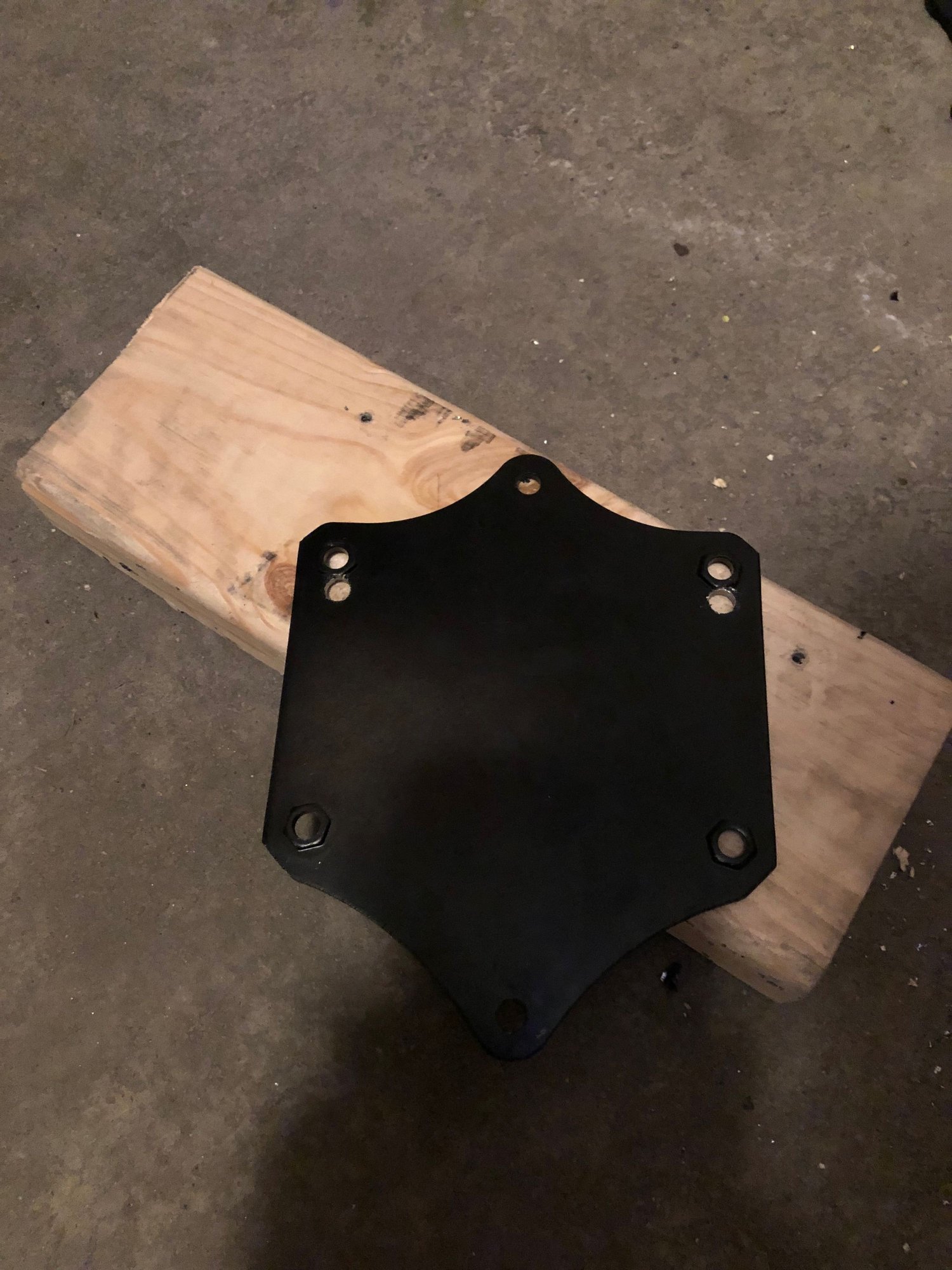

In order to have a better mounting solution I bought Thule XADAPT11 kit, which was almost perfect match to the stacker except mounting holes didn't align completely.
So I drilled additional holes and with the help of 4 Thule track nuts I now have an install I am very happy with:
Original XADAPT plate
Additional holes drilled
Stacker attached to plate
Bottom view of plate with stacker attached
Plate attached to a roof bar

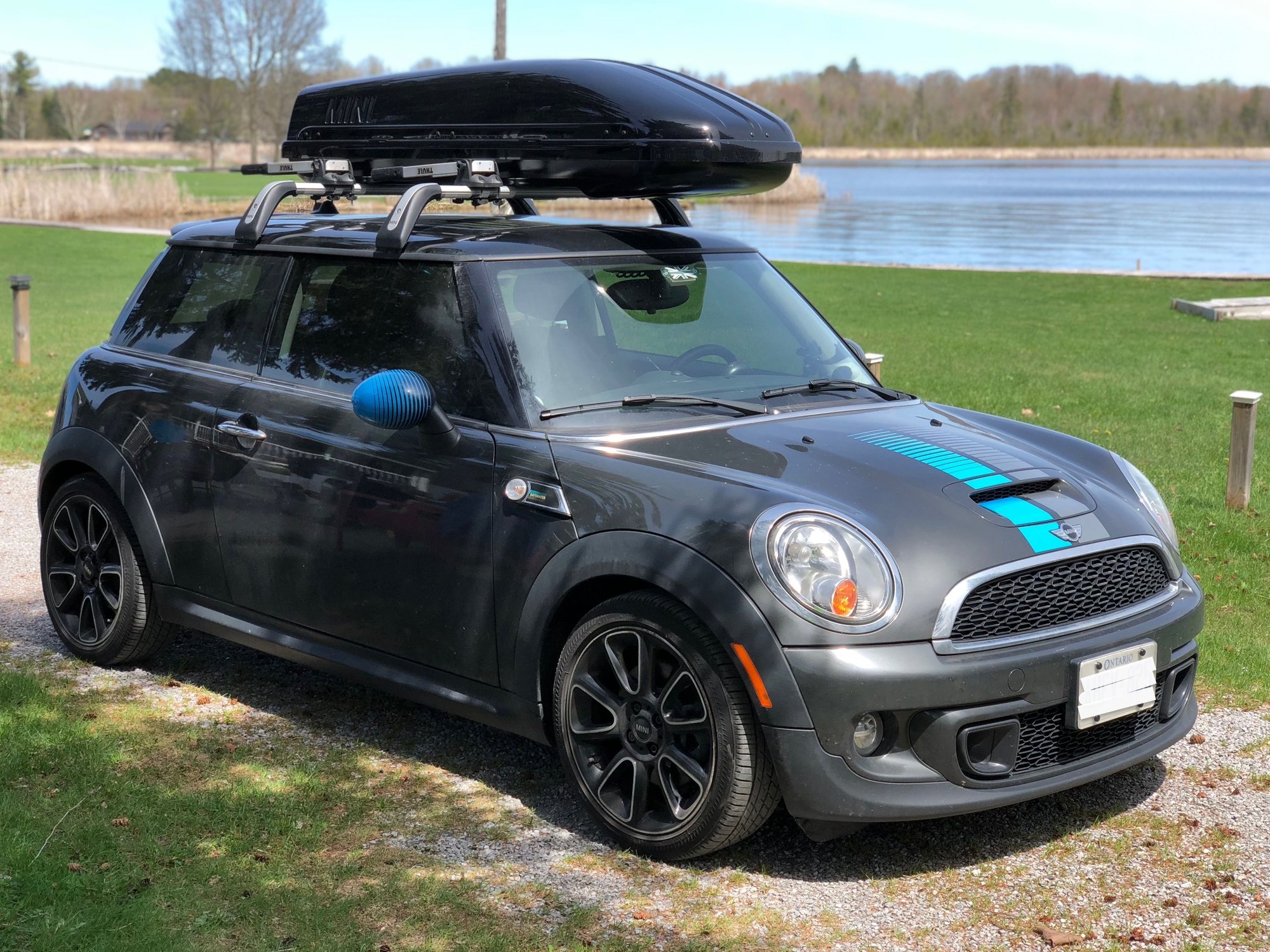

MSC resting on the beach while boat is on water (this is from very first trip - stackers are still attached with original brackets that I replaced later).
I carry 5HP outboard in the back of the car. Boat is quite light - I can lift it myself and strap to the stackers. Being using this setup for 2 seasons now.
