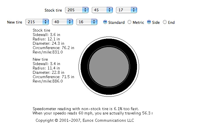

so when your speedo reads 60 you'll be doing 56.
it's not exactly 2" lower. the sidewall is .2" shorter.
the diameter of the wheel may be 2" wider but the top of the wheel cannot be counted.
http://www.miata.net/garage/tirecalc.html

i wouldnt go so far as saying that a 40 series tire is that much rougher than stock.
stock sidewall height for the 17" rim is 45% of a 205 width rim = 92.25mm
your proposed 215/40 = 86mm
that's a 6.25 mm difference in sidewall height... just food for thought.
edit: but then again, im comparing it to the 17's which a lot of people consider to be starting off stock as a harsh ride....
