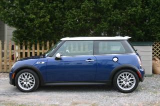

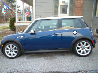

Originally Posted by tpetro33
Would the taller sidewall ruin the ride or are 15's just not "cool" looking???????
Any thoughts????
tpetro33: I think it's a combination of factors. Take a look at the images below. Many people think the 17 inch R85s really complement the overall design of the car. They're heavy, but sturdy. They don't vent the brakes very well, but they somehow just look right. The ride can be very harsh with runflats. Going to a 15 inch wheel you gain ride quality; turning, braking, and acceleration response; but you lose grip (with OEM tire sizes). You are limited to tire width by the width of the rim. For a winter wheel/tire combination in a pot-hole prone area, it's a good combination. Once you look beyond the OEM 15 inch rims there are several that look great like the Konig Rewind. Many people such as myself have opted for the middle ground, going for 16 inch wheels. My regular summer wheels are 16 inch R90s which you don't see too often, and Kosei K1 Racing wheels for autocross (not pictured). People who autocross in the stock class and want an OEM wheel prefer the 16 inch Y spokes (R84) because I think they're the lightest stock 16 inch wheel. Hope that helps. (I'm thinking of selling the 15 inch R82's if anyone is interested, PM me.)
Attached Thumbnails Why not 15's??????-r85.jpg   Why not 15's??????-r90.jpg   Why not 15's??????-r82.jpg
