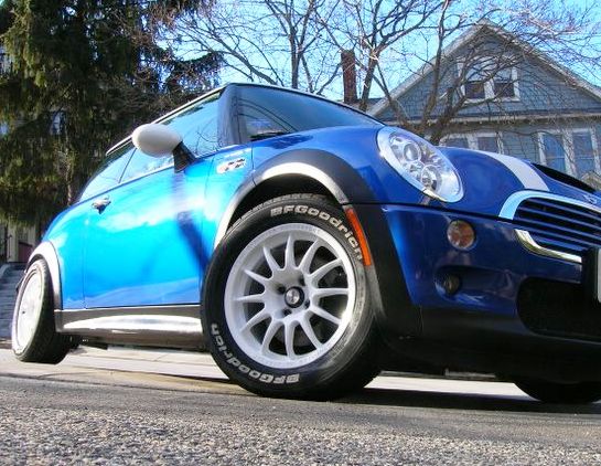

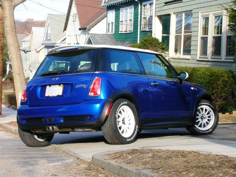

<thread Resurection>
I just wanted to share some pics... thinking of happier, warmer, faster days...
My 2005 MCS on Wwwwiiiidddddeee wheels.
RM2k5
Attached Thumbnails Why not 15's??????-rear3_4viewafterdetailing-1-....jpg   Why not 15's??????-sweet_closup.jpg
RM2k5
Are those 8"? Pro Race 1 or 1.2? Tire size? Lowered or stock hight? Rubbing or no rubbing? Shaved or natural? Oopps wrong forum! Inquiring minds want to know!

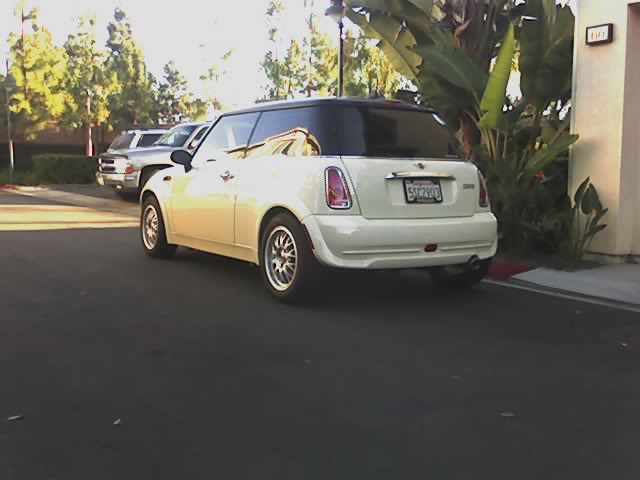

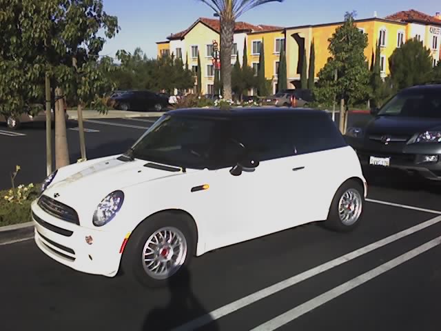

15 Bbs Rgf
I love my 15s - had holeys for 1st year, but when I went to 195/60/15 Toyos, the narrow, 5.5 inch rim width just wasn't cutting it - bought these BBS RGFs from Patogonian GT here on Marketplace - imo they are perfect for the Cooper - 15X7 and only 10.6 lbs. (forged). Here are a couple of pretty lousy pix from my cell camera - '06 Cooper, Mymini exhaust, 19mm rear Hsport bar - JCW springs & FSDs next.
Attached Thumbnails Why not 15's??????-12-30-06_1424.jpg   Why not 15's??????-12-30-06_1548.jpg
Because I hate to keep inquiring minds waiting...
-Team Dynamics Pro Race 1.2's, 15X7, ET30 (very wide stance)
--Very light wheel from Outmotoring.com
-BFGoodrich G-Force Sport, 225/50/R15 (and they are a WIDE 225)
--I have been VERY pleased with these tires, very sticky, quiet, and durable.
-Stock Height Springs on Koni FSD's
--Boston roads are too horrible for lowering
I had to trim the rear fenders, and rear fender liners to fit such a wide wheel/tire combo, but the payoff is awesome. Great grip, and a much improved ride.
~RM2k5
