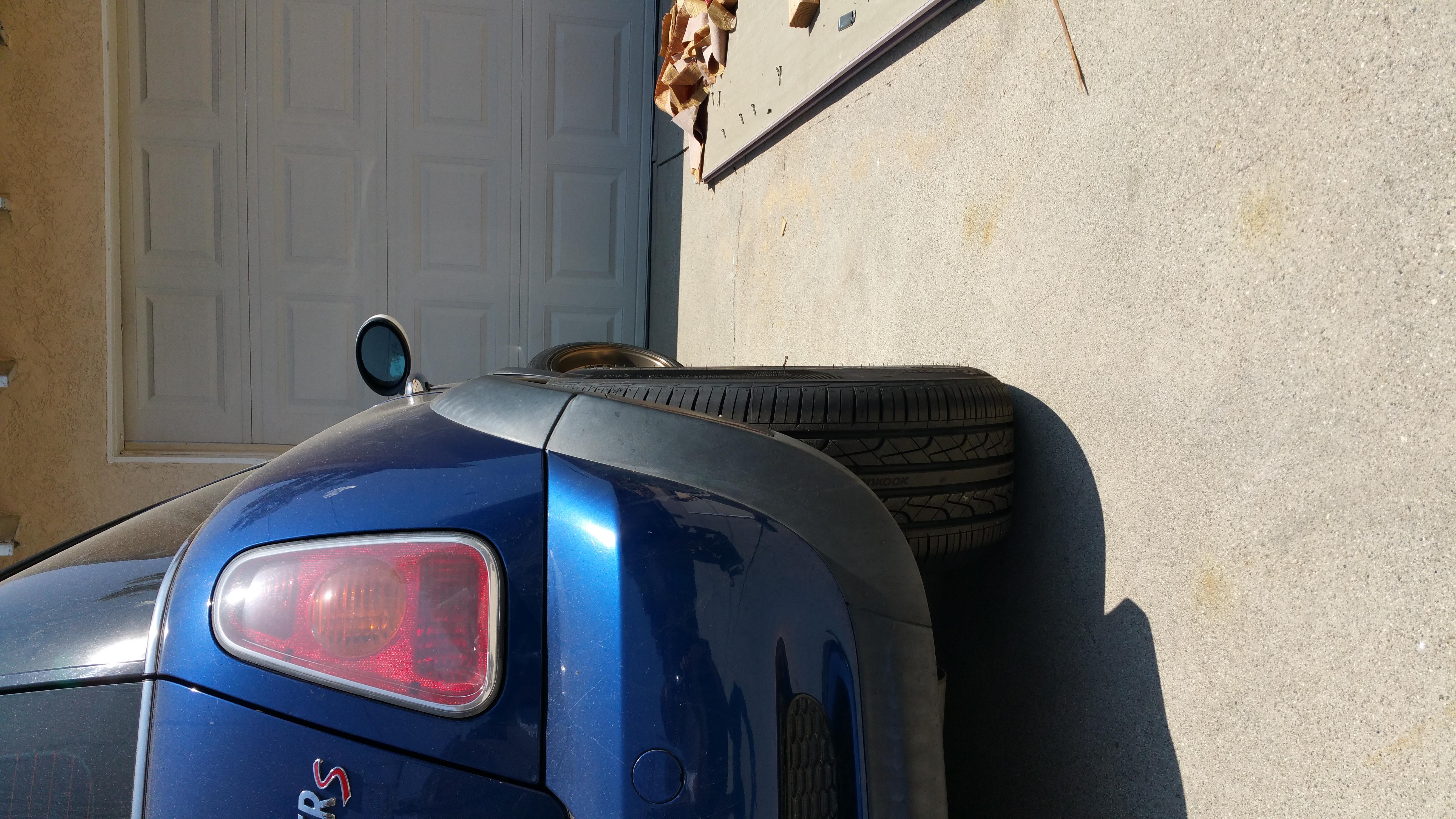

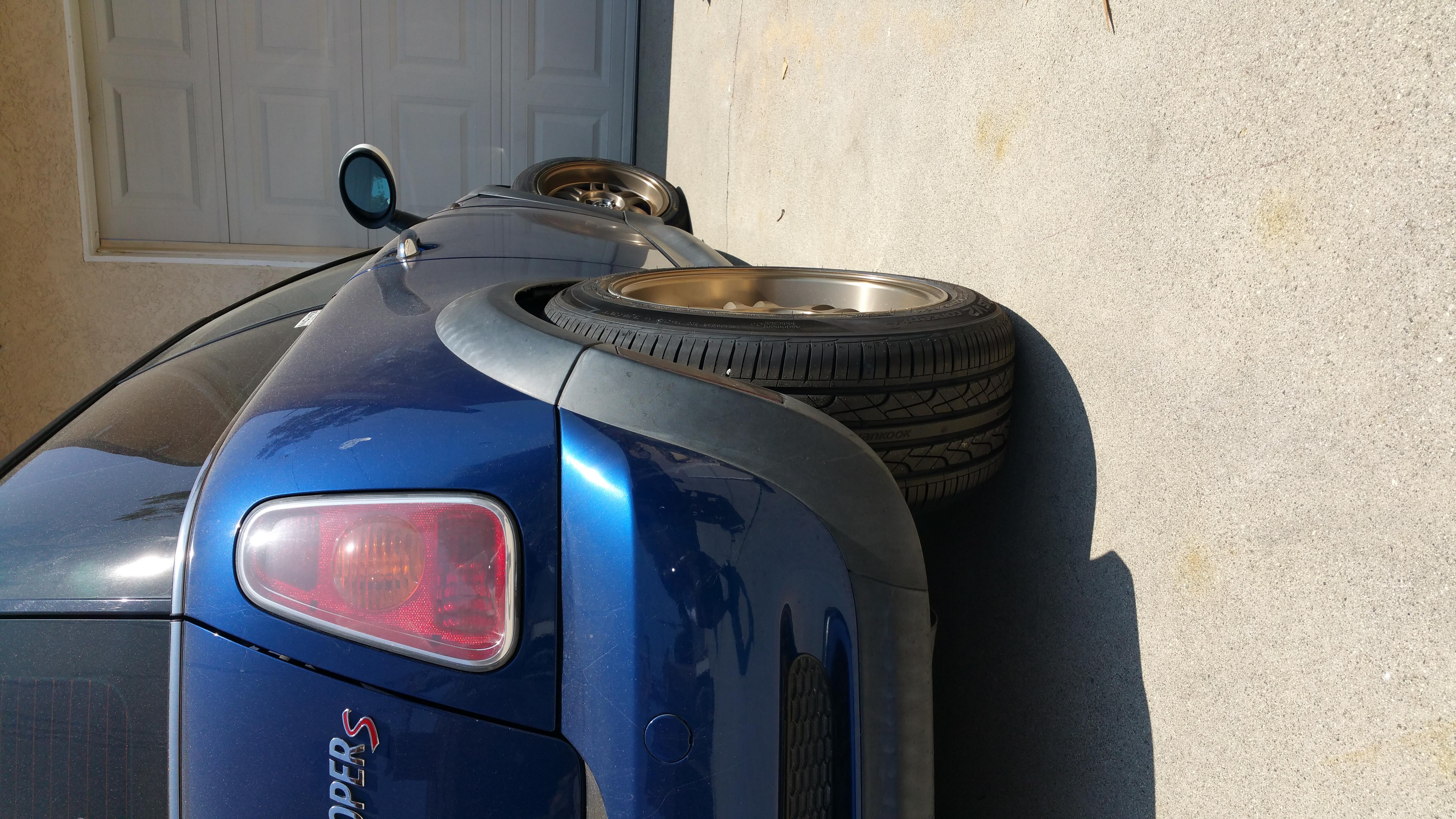

Old Aug 23, 2016 | 11:43 AM
gta18's Avatar
gta18
Joined: Jul 2010
Posts: 39
Hankook 205/50r15
My megans coilovers are at the lowest height setting. Camber At THE Back Are -1.5 According To My Galaxy note 4.

Old Aug 26, 2016 | 09:17 AM
Alex@tirerack's Avatar
Alex@tirerack
Joined: Sep 2002
Posts: 3,343
From: South Bend Indiana
Can you post a pick from flush with the body at the back of the car? It would be cool to have pic of the poke documented. Thanks

Old Aug 31, 2016 | 09:08 AM
gta18's Avatar
gta18
Joined: Jul 2010
Posts: 39
Here's some shots
Attached Thumbnails Will 15x8 et20mm fit?-20160826_123444.jpg   Will 15x8 et20mm fit?-20160826_123436.jpg   Will 15x8 et20mm fit?-20160826_123450.jpg   Will 15x8 et20mm fit?-20160826_123459.jpg
Old Sep 2, 2016 | 07:44 PM
isamin's Avatar
isamin
Joined: Feb 2013
Posts: 418
Likes: 16
Evidently you do not drive fast (FAST) or you will brush the lips of MISS DEATH with that setup if there is any compliance in the suspension. Get out the ruler,they don't fit SAFELY. If you're looking to fill the wheel wells I run 235/40/17 on 17x7.5 with ET 45. as a comparison.Also car is dropped 2" and doesn't scrape or rub. Backspacing (ET45) is a critical safety angle.
