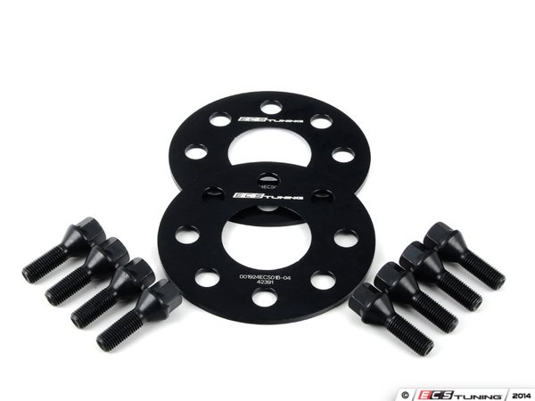

I have the stock S lites on my R53. Offset is +48. What size wheel spacer (or what offset in other words) would make the wheels flush to slightly poking? Stock sport suspension if that matters.
Old Jun 10, 2015 | 12:50 PM
Posts: 36,758
Likes: 2,548
About 15mm to 20mm on average depending on wheel and tire on 17" stock MINI wheels 205/45/17 and also how low you are and the et of that wheel.
25mm poke a bit and 30mm poke serious. Some people like that.
http://www.ecstuning.com/Mini-2005-Cooper-R53-S-Coupe-L4_1.6L_W11B16A/
Use our guide here to find out what you like.
http://bd8ba3c866c8cbc330ab-7b26c6f3...gapdiagram.pdf
