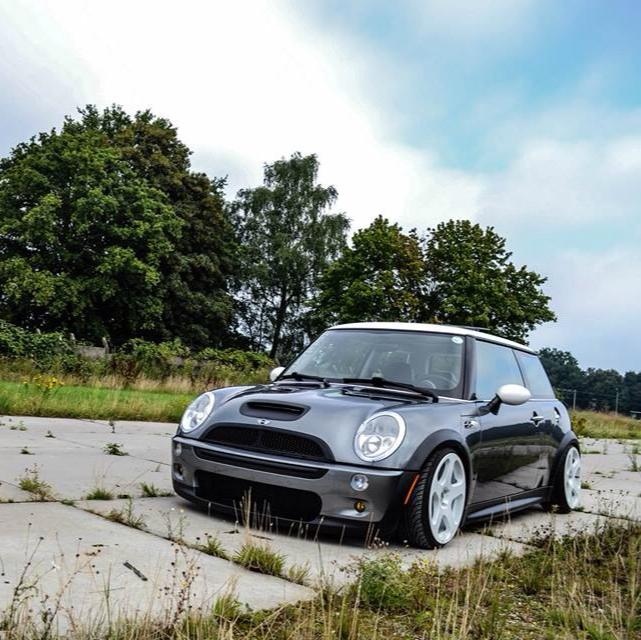

Originally Posted by minsanity
A clearer pic of the R53 on 16s:
Could someone please tell me what wheel this is and a possible source to purchase a set?
Old Mar 19, 2015 | 10:18 PM
  #30
AlexQS's Avatar
AlexQS
Joined: Apr 2013
Posts: 731
From: Near Portland, OR, USA
Minisanity said earlier in the thread that they're rotis
I think he meant they're
Rota Grid 16x8 et 20.
Edit: here's a link http://www.aspecwheels.net/index.php?route=product/category&path=20_27_1000_2025_2026
I've never done business with them though. Don't forget to get hubcentric rings, I think they're super important to get the hub bore sizes to match, and fit each other like a glove... The weight of the car should be carried properly on the hub center, not the lug nuts.
