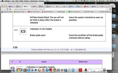

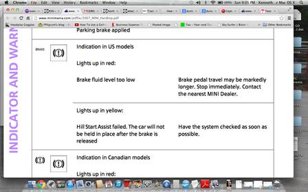

During one run at my autocross today a weird warning came on. It was the BRAKE and then the brake symbol in the center of the tach. When this happened it would not allow me to turn off traction control. From the owners manual the following is a picture of what I think was being shown. Its either one of the two pictures, I think its the one that says worn brake pads but not sure. I checked brake fluid level and all is fine. Brake pads are thicker than half pad. When I check the service info on the OBC for the brakes it says 14,000 miles left on the front and 28,000 miles left on the rear. I have 10,200 miles on the car.

Attached Thumbnails Brake warning light & unable to turn off traction control-screen-shot-2013-07-28-at-9.05.18-pm.jpg   Brake warning light & unable to turn off traction control-screen-shot-2013-07-28-at-9.06.06-pm.jpg
