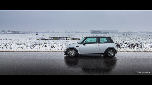

On Holies/15s + R56 Brakes, ask Professor & MartijnGizmo over at m|u:
Martijn's on Holies:

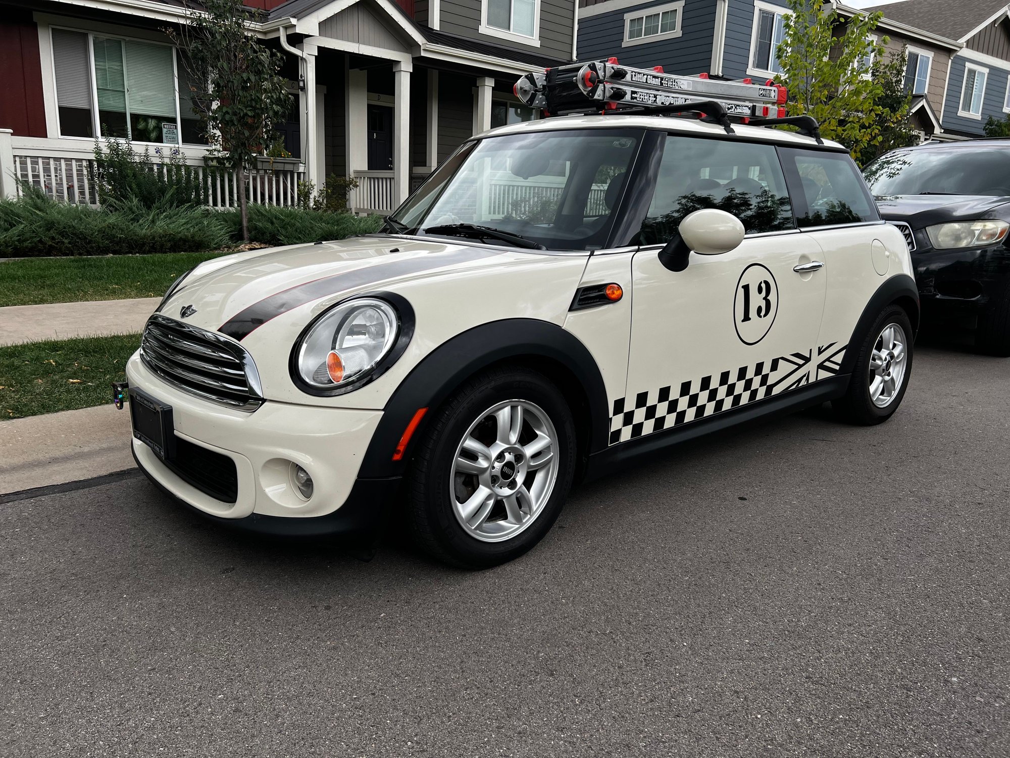

I have 15 inch 4 x 100 rins on my r56 2012 mini Cooper right now
Originally Posted by tremperj
Some 15's can fit. I believe I have read of some folks running SSR and Slipstreams in a 15" size. But those Imola Holies are not gonna fit your R56, sorry. Sad, its a great looking wheel.
This is my R56 base model I am putting the s model spoiler on :-) I'm glad it will fit
