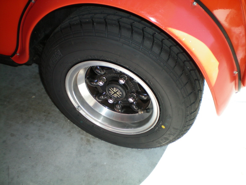

does a 165/70 10 on a 6 inch wide rim count as stretch?
could be something new to put on the show sign!
