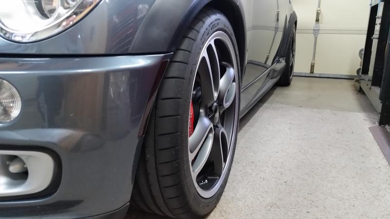

Originally Posted by djmatthewcooper
Quikmni, how did you like your 215's on your 7" wheels? Did the tire look too fat? You think I should go with 205 or 215 on the 18x7 OZ Superleggera?
I really like 215 on the 7" wheel. I think they look good and not too fat for the wheel. I used 215/40-17 on my 2003 and 215/40-18 on my 2006. Attached is a photo.
