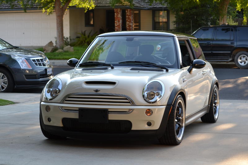

Would you happen to have a side profile picture of your car with the drop?
5mm will hardly make a difference, that's normally used if you have some tire rub on some suspension part. Very hard to even notice that.

Only one I have now.... Dark... been drinking.
As you can see... Minimal drop.
Don't mind the old MINI... getting in the way all of the time.

You should be fine. I had R98s and 15mm spacers in fronts(for BBK clearance) and also lowered on coilovers(not too extreme, but no wheel gap). No rubbing on the fenders.

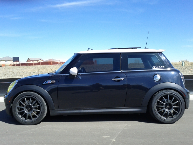

Yea you should be good.
The drop is minimal.
There are ppl running 17x8 ET38 with 235/40.....which is practically the same diameter as 195/55/16.
Wow stupid app, disregard that third picture haha.
But that pic gives a good way of measuring what spacer you can fit.
The car below is on swift springs which drops it 1inch all around
Attached Thumbnails Advice on Widening Stance Needed Please-image-75671959.jpg   Advice on Widening Stance Needed Please-image-2616115442.jpg   Advice on Widening Stance Needed Please-image-177738430.jpg
