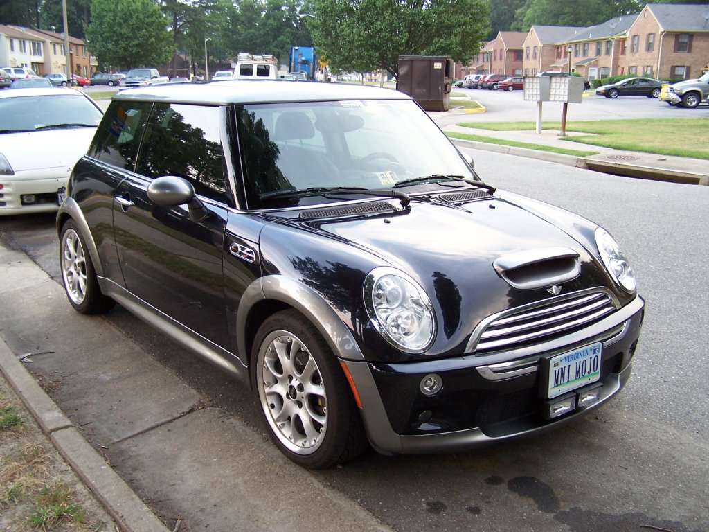

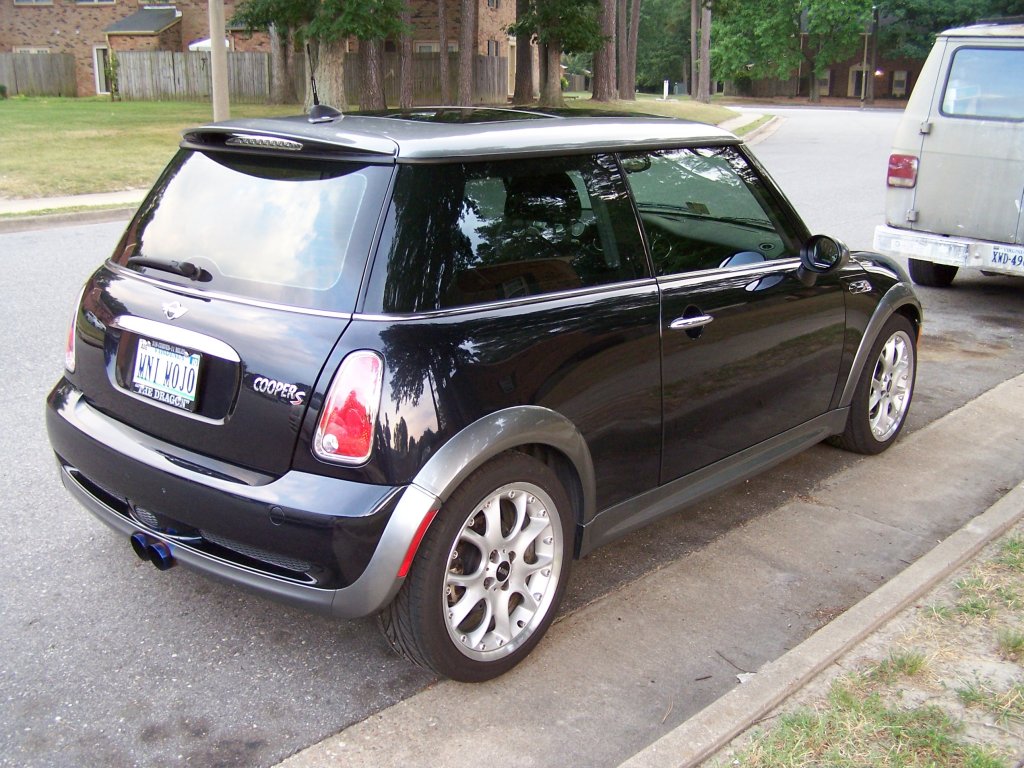

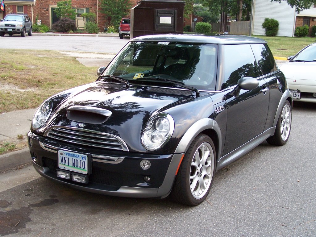

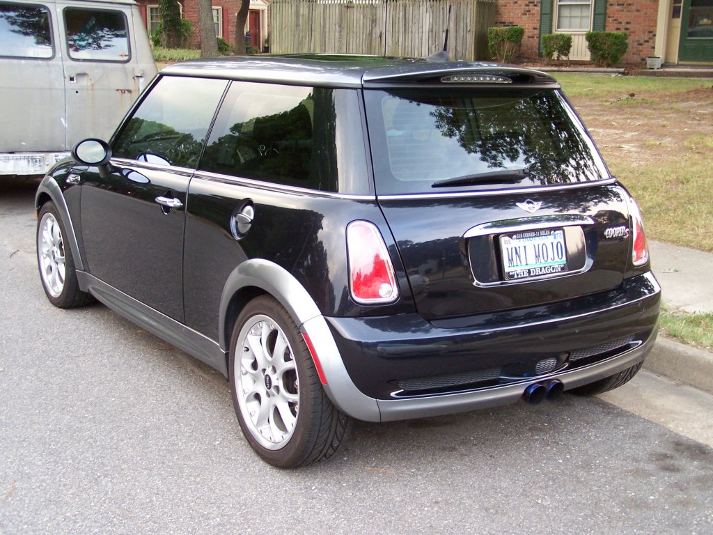

I have the Web Spokes as well. The outer aluminum rim has a clear coat on it. If that seal has been broken, the only thing you can do is to get it recoated. The coating is slowly peeling off at least two of my rims. Not sure what I will do in the future about it, aside from getting some aftermarket rims I have been eyeballing for awhile.
If the center (painted) section is scuffed, and the scratches are not very deep, try picking up a bottle of 3M 3000 polish. It's like a liquid version of 3000-grit sandpaper. I just used this on my entire MINI this past weekend. I did not even use a buffer; I applied it in the same manner as a wax. In places were the scratches were a little more pronounced, I buffed, reapplied, and buffed again. That stuff made the entire surface of my MINI feel like a baby's bottom. I had a slight shadow effect in the clear coat down the sides from the top edge of the doorway down about 8-10 inches. That's all gone now. Make sure to wax afterward.
Previously, I have used Eagle One Nano Wheel Polish. I'm not sure of it's density, so it could be similar to the 3M 3000 product. I do recall it make the wheels smooth, too. Perhaps use the 3M first, then the Eagle One polish last.
I took these pictures after I finished:
http://www.cybertekit.net/mini/2006/mini026.jpg
http://www.cybertekit.net/mini/2006/mini027.jpg
http://www.cybertekit.net/mini/2006/mini028.jpg
http://www.cybertekit.net/mini/2006/mini029.jpg
