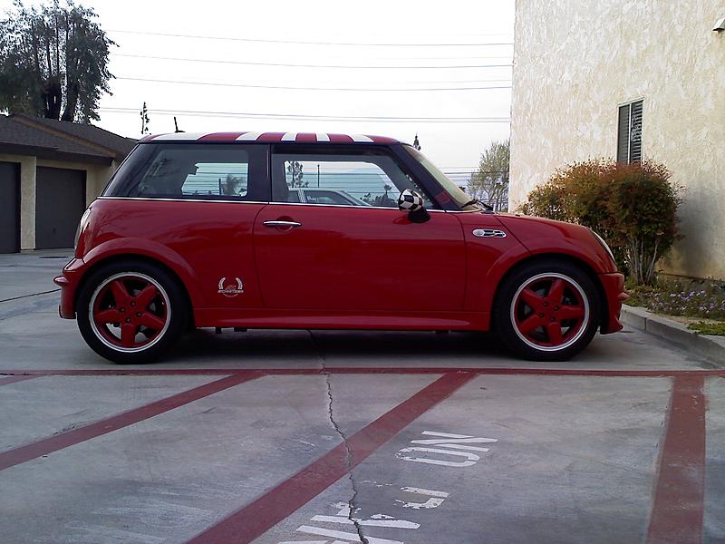

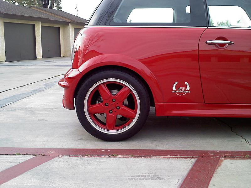

Originally Posted by nabeshin
Any photos of what it looks like with those 225/45/17 tires?
here ya go
Attached Thumbnails tried to decrease the wheel gap and now....-225-45-cont-ec-dw-2.jpg   tried to decrease the wheel gap and now....-225-45-cont-ec-dw-1.jpg
Old Apr 3, 2010 | 04:32 PM
Mr Silverblood's Avatar
Mr Silverblood
Joined: Jun 2008
Posts: 189
From: Worcester, MA
I know someone who put 225's on 15 inch rims, and those who have driven his car say it rides like a Cadiliac. Basically saying it rides awesome.
Nice pics too, looks great!
