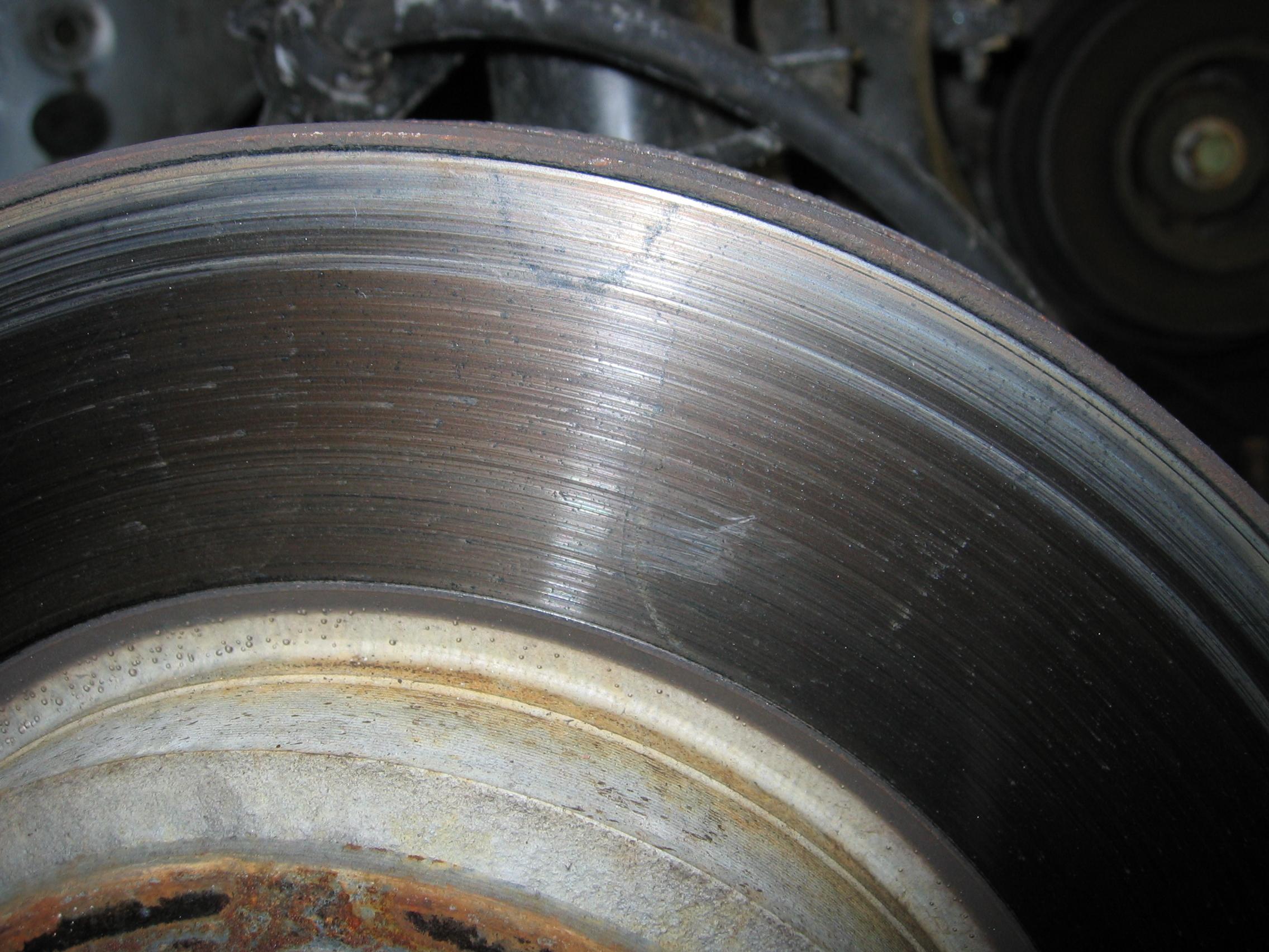

Well I finally got around to pulling the passenger side wheel and this is what the rotor looks like. From what I can tell this is definitely the cause of the vibration. How would I go about cleaning up this surface? Turning them or would a very light sanding do the trick?
Sanding will remove glaze and help new pads bed in....your only real option is to pull them off, and have the put on a lathe the recut them...since they are fine cool, and they seem to vibrate when heated, this could be a waste of money.
It does look like you have an intersting stain....Maybe a bad rotor?
With the marks like that on a newish rotor, I wonder if the pads are glazed/leaving deposts on your rotors....
I would do new pads and new rotors. If you have the rotors cut...the pads should still be replaced or bedin time may be long, and inital brake performance maybe dangerous till the pads are shaped to the newly flat rotors....IMO do it once, do it right, do it safe!!

When I zoomed in and looked at the rotor surface...wow...looks kinda bad...very irrigular, potmarked almost...kinda odd looking!!

Yeah... those should NOT look like that...

From research I've done, pitting can be caused by rotors that aren't used very often. The previous owner said that the car wasn't a daily driver and would sit for periods of time. That would explain the pitting and the marks left on it from the pads. I think come spring, I will get all the rotors resurfaced and pick up some new brake pads.

Pitting, scored surface finsh and a lot of other unsightly things do not cause pulsation in pedal. Go to Stoptech website and read White Paper on warped rotors written by Carroll Smith. (Warped rotors is mostly myth)
A few hard stops may knock pad build-up off rotors, but some pad materials seem to bild up high spots on rotors. Hawk DTC-70 pads seem to do it on Corvettes.
If you are not doing track time, switching to a cermic pad might fix this.
Also some people have had good success in cleaning rotors with coarse sandpaper.

Rotate that thing about ten degrees to the left and you'll see the entire pad print embedded onto the rotor. Either; hard stops with foot held onto the brake pedal (car automatic trans?) or sat overnight in the rain and bonded at that point.
Looking close I think I see another foot print to the left as well.
Yea they're all over the rotor. Do you think a light sanding would help in the meantime (before I can get the rotors turned and new pads)

I'd certainly try it. And hit the pads on some as well, then bed the pads a bit and see if the issues are gone. If you have it; a scotchbrite wheel on a air sander works well.
