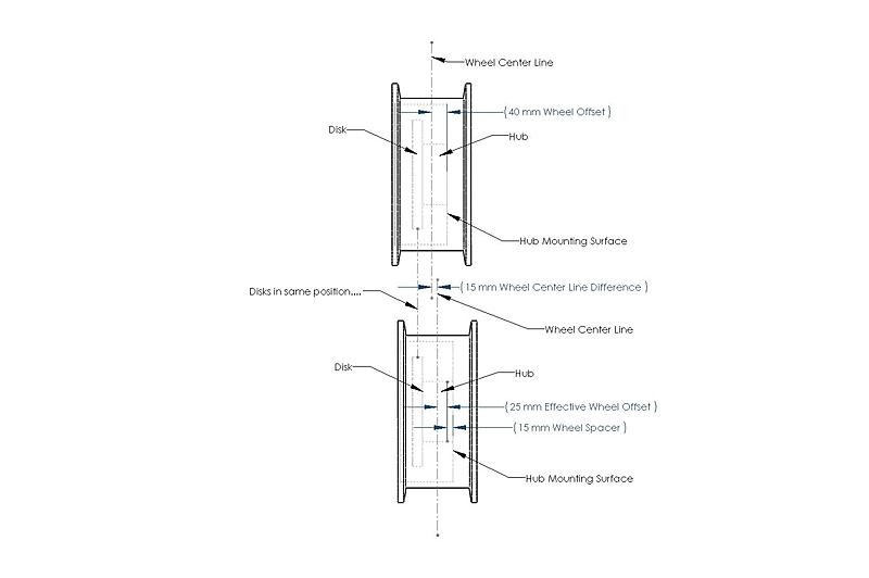

Think of adding a spacer as simply adding material to the inside of the wheel where it mates with or contacts the hub on the car. And material you add there will move the wheel out the same amount. It doesn't matter if it's a separate spacer or the wheel manufacturer has left an equivilant amount of material there. The wheel ends up in the same location.
Here's a drawing that may help explain things:
As for the added load on the wheel bearings, it's the simple physics of a fulcrum. Imagine that you've got a small hole drilled through one of the interior walls of you home, right through the drywall on one side and through the drywall on the other. These holes represent the two wheel bearings on your car's axle. Now, take a steel rod and insert it through both holes in both walls. Then, press down on the rod with your hand about 6 inches from the wall. The holes in the drywall (wheel bearings) may give a little bit, but they'll hold up pretty good. Now, more your hand until it's 2 feet from the wall and press down with the same force as before. Now the holes in the drywall (the bearings) become badly distorted and deformed, not because you are pressing harder, but because you've got more leverage. The same things happens when you start moving your wheel further and further out away from the wheel bearings. The even though the force applied by the wheel remains the same (the cars weight on that wheel), the forces that the wheel bearings have to deal increases because of the extra leverage from the wheel being further out.
Fortunately, most cars are fairly well over-designed and 15 mm or so usually isn't going to make much of a difference in the long run.
'Hope that explains it.
