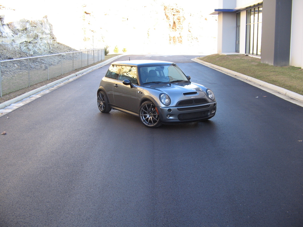

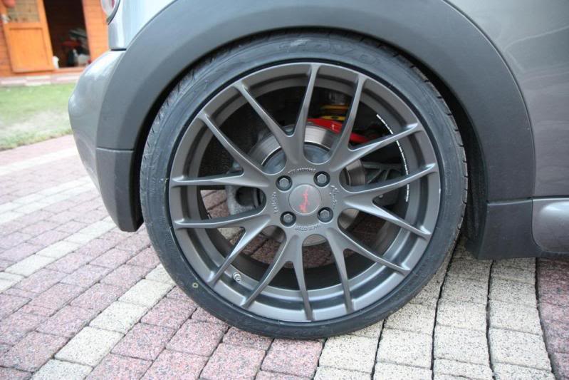

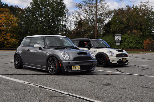

Is there anyone with a dark silver Mini that has the grey Breyton wheels? If so could you please post any pictures you might have. I am consered that the Breyton grey might be close enough to the dark silver that it looks like you were trying to match and missed but it may be enough different that the contrast of grey's will look good. BTW I have a set of black wheels OZ Alleggerita's and I do not like the black color wheels on my Mini and I also have silver OEM challenge wheels that I like better but are too heavy.
Here are a few examples that should get you close. The first two are matte grey Breytons, and the last three are for color only.
Hope this helps
