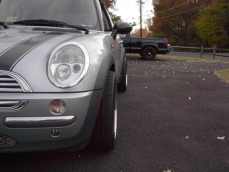

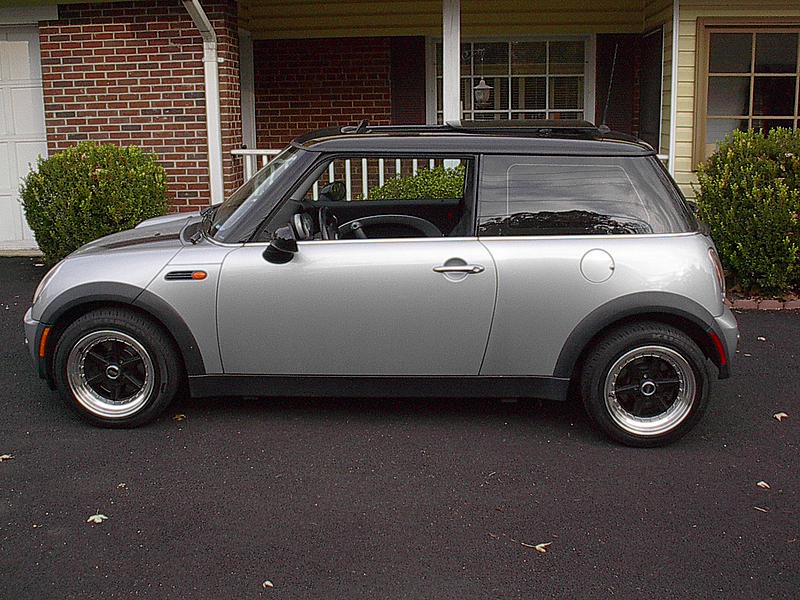

bassles's Avatar
bassles
Joined: Aug 2007
Posts: 45
From: dc
Mr. D you should not have a problem getting 15" tires down the road. Not only that but the price is much cheaper than 16-18" tires. I have had my rims and tires on now for a month or so and the poke and gap is just fine at stock heigth. If I was to lower my car it would cause tire rub. I had four big guy's in my car the other day and it caused it to rub just on the inside of the flare. The tires do not stick out beyond the flares and I dont get water spray from rain soaked roads.
Attached Thumbnails 15" aftermarket wheels on a MINI-sew002.jpg   15" aftermarket wheels on a MINI-sew005.jpg   15" aftermarket wheels on a MINI-sew006.jpg
