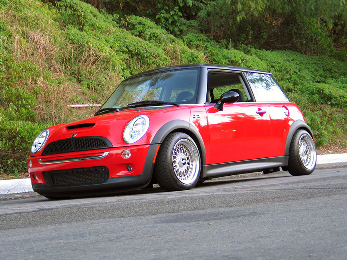

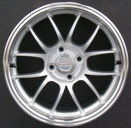

Thanks Snid for the post. I can't say enough good things about these wheels and 949 Racing. They are 15x8 with an offset of 36 @ 12.9 lbs not hub centric and no rings are available. I got them early this season with 225x45 Toyo RA1's. Things have not been the same sense! Ask SNID. Needed 5mm spacers in the rear and there was some rubbing that HAD to be managed with the baseball bat trick (lowered a lot on Bilsteins). On 949 Racing. I ordered on a friday and received them by Thursday the next week from CA (I'm from RI)! He will have more sizes available for 2008.
