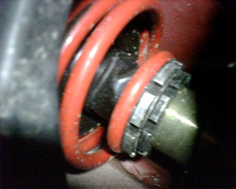

... I'm not expert enough to know exactly how a bind issue would reveal iself, I have some track experience... and so do some other folks that put my car through the paces. I've driven it near the edge into corners and everything seemed to behave as intended. It seemed as the though the tires were letting go in a predictable way, without sudden understeer/washout/plow/etc... I can say it bucks more than I'm used to on roads with poorly engineered/leveled or ungulating surfaces; I had been attributing that to the short wheel base and limited supension travel... maybe I'll drive the front corner up on a piece of pressure treated 4x4 I have in the garage and see if the spring looks like it wants to bind. Thanks for the heads-up.

... maybe I'll drive the front corner up on a piece of pressure treated 4x4 I have in the garage and see if the spring looks like it wants to bind...
OK... now I'm a little skeptical about these springs I took some pictures and you can defintely see something may be a little sketchy. I'll post the pics tomorrow. Intuitively, these springs look like they just might F you up if you were pushing the limits.
Than again i read this thread:
https://www.northamericanmotoring.co...ght=h%26R+bind
...this thread has me believing some binding is not only normal but necessary when it comes to prograssive springs; but it begs the question, how much binding is normal... especially when a car is resting peacfully in ones garage.
I'd say ignorance is bliss, but there is nothing blissful about heading into the gravel trap in turn one... major kudos to meb for bringing this to my attention.

Every spring has what is called block height - the height or length of the spring at full compression. Block height is an important figure to keep track of when selecting springs because although it obviously changes with length, it also changes with rate for a given length; a 400#, 6" spring will have one block height and a 300#, 6" spring will have a different block height...the 300# spring will have more spring travel, and therefore a smaller block height, because the coils are thinner.
...So, if your front springs have but one working coil left, that is not enough. The amount of travel available is limited to the actual range of motion this one coil allows.
You will notice spring bind on a smooth race track if you are indeed pushing the car to its limit. It will show up as a slide or loss of traction. This may be subtle or very apparent; it depends on the rate and severity of weight transfer.
On the road it will show up as a bit of pogoing; as the front spring reaches block height - no more suspension left - the rear takes up the slack...and when a spring reaches block height, it becomes infinitly stiff. Tire compliance and the rate of the rear springs and rear sway bar will affect how this all feels. If this H&R kit had heavy rear springs, you would notice spring bind up front easily. The car would go thru a series of very obvious front to rear oscillations.

here are the pictures I took... not a great pic; but, this is what it looks like at the left front corner when loaded with most of the weight of the front end (brought about by parking it on top of a 4x4, not sure how it compares to cornering load but it is defintiely pretty heavily loaded)...
Attached Thumbnails Ireland Street/Race plates modifications...-loadedspring1.jpg   Ireland Street/Race plates modifications...-loadedspring2.jpg

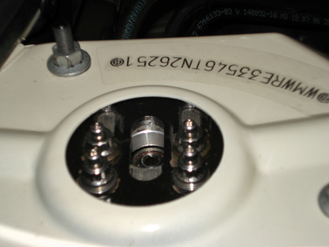

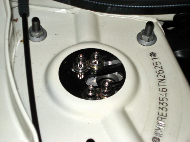

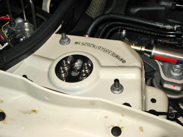

IE Plates with ARP Studs
Meb, here are the pics you requested. One or two did not focus very well. I guess it was the loose nit behind the wheel.
Does this post only allow you to attache 3 pictures at a time? I have a few more different angles but you will get the idea from these.

Here are the other angles for good measure
Attached Thumbnails Ireland Street/Race plates modifications...-dsc00212_edited.jpg   Ireland Street/Race plates modifications...-dsc00201_edited.jpg
