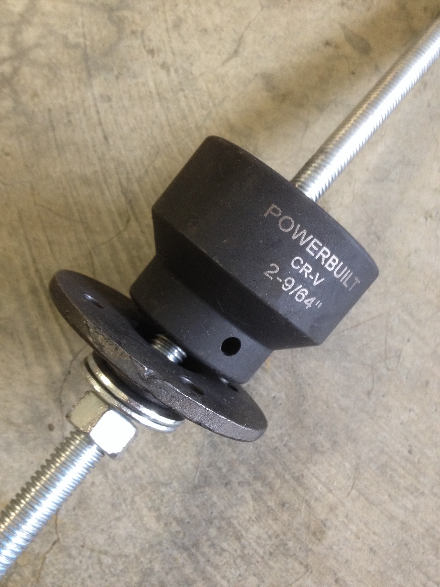

SuperPro SPF2548K
SuperPro had a video explaining why their bushing was better than others and it made sense to me. I also found it for a slightly lower price than the Powerflex product. The kit came with grease to ease the coupling of the two bearing parts and I decided to do the replacement without dropping the subframe.
After nuts were most of the way off, control arms were loosened using sledgehammer inboard of outer ball joints then aft and outboard of inner ball joints. Removed control arms with pry bar. Sawzall (air body saw may have worked too) used to cut away old bushings. 1/2" pipe floor flanges with half inch stud a foot long pressed in new bearings most of the way. Then the aft flange had to be modified per the 1st photo (only 1 of 4 cord ties is shown) and the press assembly tightened until the modified flange fractured. The front side of the press used a 2-9/64 CR-V from Adv. Auto KIT46 per 2nd photo. Ratcheting tie-down strap for reinstallation of control arms. Torque specs for control arm: 41 & 59 ft-lb. (5 & 6mm T-handle wrenches and 18 & 21mm crows-foot wrenches are very helpful for torquing.)
