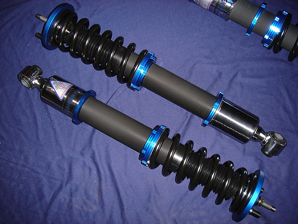

Just got these from M7 yesterday:
This is what they look like unpacked. Clearly the rears are not adjustable for ride separately from adjusting the spring compression, but the fronts are. I presume you fit the rears, then adjust the fronts to get the desired ride height balance between F and R. I am waiting on some Powerlinks before installing and an align/corner balance.
Doc, I pulled this from the M7 website: "The coilovers feature 15-position compression and rebound “click” adjustments, plus height adjustable settings." This seems to imply separate adjustments.
Not trying to doubt you, just trying to resolve your observation with the product description.

Well, looking at the rears, there's only one locking ring, so only one adjustment. This sets the "pre-load" on the spring, which will affect the ride height, but also the effective travel of the piston for a given load or impact. The fronts have two lockrings, and two adjustments: the height the piston sits in the housing, which will affect ride height, and the compression of the spring, which will affect travel.
So, as Randy from M7 has stated, the ride height is adjustable both front and rear, but not in the same way, and the rear ride height is adjusted at the expense of another (perhaps important) parameter.
mbcoops: I certainly anticipate taking these out to the track as soon as possible! But I was sent the "stock" springs, which are 240lbs front and 280lbs rear, I believe.

No problems: I just posted on the issue of ride height and piston travel, so that's one issue, but there's also "compression and rebound" which *is* separately adjustable via the knurled ***** at the bottom of the units (you may be able to see them on the fronts more clearly, they are about 5/8" diameter right at the bottom) But my understanding is that compression and rebound adjustment affects the rate at which the piston moves inside the chamber--what we would call damping. The spring, onthe other hand, determines other characteristics of the system, including ride height. My appraisal of the units is that ride height is adjusted differently (or at least can be done so) on the fronts as on the back units.
