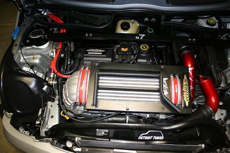

I goes really smooth. You dont have to change or modify anything unless you have the old shrooming. Then you just kind of go to town for a little bit.
You realy dont have to worry about the bonnet liner... just tell where it hits the bar and then spray a little water on it and close it over night. It will form to your nerw mods.
The pic below will help you.
