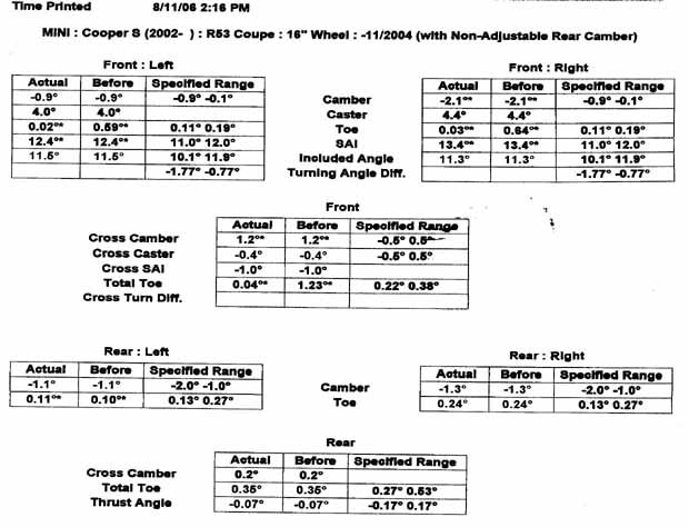

Had an alignment done today. I have the Helix camber plates. Recently installed.
Bear in mind I haven't messed with alignment specs in 30 years and things have changed a bit but I'm thinking my before and after settings, especially camber are crap. Toe I'm not sure of because this readout is in degrees and I'm used to fractions positive and negative.
I seriously need help because, like a dope, I trusted the morons and didn't read the specs until I got home.
They told me the camber plates wouldn't go any further. I asked for -1.5 camber and 3/32nds toe out. Why the he!! would they leave my right side camber at -2.1??
Here's the scanned in before and after specs.
Heeeeelp!!
Attached Thumbnails I need help - Alignment issues-before_settings.jpg   I need help - Alignment issues-after_settings.jpg

Looks like they didn't even try. Did your target alignment specs make it onto the work order so the tech saw it? (The time-stamp on the right-hand sheet says it's the final, and includes a front toe change that is not on the first sheet.)
The front toe is close to 0, rather than your requested toe-out.
And there is a full 1 degree camber difference side-to-side in the front, and that is just unacceptable when you have adjustable camber plates.

Yep, right on the work order which I have a copy of. I just wasn't and still am not sure what the toe reading equates to. In or out and how far from 3/32nds is it?

The printouts you received are a bit confusing because there's a "before" and an "actual" (assuming this is means after) on each page. After staring at them for a couple of minutes, it looks to me as if only your front toe was adjusted. Camber was not touched, nor was rear toe. Did they simply forget to finish? My alignment shop usually meets my specs down to +/-0.05.
As for the fractions, 1/8 = 0.125, 1/16 = 0.0625, 1/32 = 0.03125. So you have about 1/32 front toe in rather than 3/32 toe out.
I had assumed those were the readings. In being positive and out being negative. Thanks for the confirmation.

Also, make sure that they put weights in the driver seat, and do all the alignment stuff with the weight in the car. You're unweighted specs will look funny, but who cares, you're in the car when it's driven.
