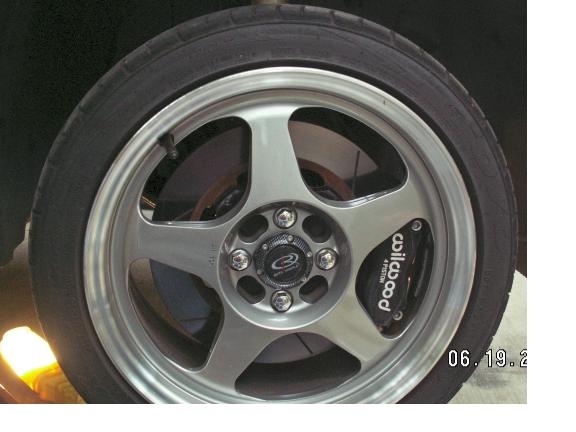

I would do Brakes now. I would put brakes as second behind a 22mm rear bar. On the track you will destroy your factory brakes if you push it. Mine did not finish 4 sessions before I was into the rotors (8000 miles at the time). At least get better pads all around (I like Hawk HPS), brass bushings (a must in my opinion for track use) and better brake fluid (Motul is my favorite). Get steel lines if you want to get the pedal off the floor - this helps with heal and toe a lot. I ended up going with a Willwood BBK in front that would fit under 16" wheels. The smaller wheels 16 or 15 are highly recomende with short tires (I run 40 series on 16") the gearing advantage picked up will be greater than the advanbtage from a pulley or exaust. off course I would do those also - but after the brakes.

Let me first start by saying you are going to have a great time at VIR. There were 4 MINIs there this past weekend. Better than usual. Here's my advice, take it as you like. You will learn alot from your car in the stock format. works kit or not. My only concern is that you'll be sharing the car with your hubby. The MINI's brakes are insufficient on the track. If your going to be using them double duty you really want to do something before you get there. Much like everyone else on here i took the long route to fixing this problem. First you start using hotter fluid then hotter pads maybe even different rotors, lines, bushings... I even got cooling ducts fabricated. These are all just bandaids to a bigger problem. I did all of them and still had to bleed my brakes after EVERY two sessions. It's a lot of messy work. Everybody at VIR knew me as the guy that bleed his brakes all day long.
At some point you will figure out that you need a big brake kit. With out trying to scare you, two people tracking a MINI in differnt run groups will ruin the brakes in a day. VIR is a fast track. I'm over 120 on the front straight and don't hit the brakes til the 3 marker. 120 is a bad time to find out your brakes have left the building. The amount of money you will spend on all these little things will add up to well over 600 bucks. There is a vendor on this site that sells a wonderful BBK for 1200. I just finished my 4th track day in a row without having to bleed my brakes at all. That's what i used to spend all my time doing. This is one upgrade that you will appreciate more and more. It gives you time to learn while your at the track and not worrying if your brakes will make one more session. Easily the best upgrade i've done to my car. Lots of upgrades make your car go faster or handle better. All fun and exciting but you have got to be able to stop your car with confidence.
You can try and fix it baby steps or just do the right thing and get what you know you need. I'm sure the 997 driver will back you on this one.

This was also my final solution having destoyed my factory brakes. I di think you can try with the JCW brakes as they may be better than the base factory brakes. Just watch them and be prepared to cut your day short and head home early if they start to go.
