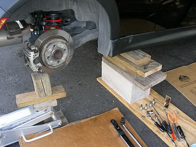

I applied torque to the rear trailing arm bolts while under load today and had a couple of discoveries. On the passenger side the bolt was extremely tight more like 200 ft-lb instead of 125 and on the driver’s side the bolt was only snug; there’s no way they used proper torque at the factory. Also each bushing had minor cracks on the bolt side; more on the over tightened side. I’ll have to replace the entire bracket since stock bushings alone are not available. At least they’re only $84 list which isn’t too bad.
After observing the trailing arm articulation and movement on the bolt side, I think the end of the arm does very little twisting. The majority of motion is only up and down (11 o’clock to 5 o’clock) so in actuality the end piece just rocks unlike the pivoting front control arm. I doubt that any pre-load would be in effect after lowering from the stock ride height. I took ground to brake rotor measurements before and after and there was no difference in the static state. When the vehicle is in motion loads will be much greater so the suspension shouldn’t see any resistance if pre-load wasn’t enough to elevate the trailing arm after applying torque at compression. Of course those of you engaged in competition should cover all the bases.
I corrected my nomenclature, one of my common mistakes, sorry.
My observations were of a pre November 2004 build trailing arm and bracket (my 12/02). It may very well be later builds have a different orientation of the bracket in relation to the trailing arm facilitating more pivoting.
It’s easy to see how toe can wander under load with my bushing & bracket design; aftermarket inserts would probably control the in/out movement, but the augmentation of suspension damping might be less controllable vertically than struts & springs for the dial-in guys.

Below is how I observed the articulation of the trailing arm and put it in a position to re-torque the end bolt. Here’s a link to another thread with a picture of the early model bushing close up on the bolt side (post #18) https://www.northamericanmotoring.co...ad.php?t=68901. There is a rectangular metal insert that bolts to the trailing arm within the bushing; it only goes one way so there’s no opportunity for “loading”, also, it doesn’t allow for twisting action.

k-huevo: I'm having difficulty interpreting your post. Do you mean that certain model rear trailing arm bushings don't require the "de-loading" that onasled refers to in post #1 above?
And is your photo intended to show the suspension as it sits fully loaded when the wheel is on the car and supporting the weight of the car? Is this a method for accessing the trailing arm bolts without the car being on an alignment lift?
cheers,
cheers,
meb, with the pre-March 03 (for sure this time) bracket and bushing the weak point would be a load pulling out or pushing (scrubbing speed, rotating) towards the bushing. Movement in these directions would turn the wheel left or right affecting toe; albeit a small amount. There is a bracket/plate under the bolt (which hangs out in space without the insert) to hold the outer insert (limiting travel in that direction) and the insert on the arm side held in by the arm. The sandwich effect would keep the bushing from moving like a diaphragm. When the arm is going up or down the trailing arm would come against it like a bump stop limiting travel. I’m assuming the lack of compressibility would be a constant that couldn’t be dialed out if need be. I’m still going to give it a try and it won’t be hard to reverse. gandini, the early model seems to be non-loadable or un-loadable for “de-loading”
The later model bushing, bracket and trailing arm is different (so is the cross member support and almost every other rear part). The bushing sticks out at both ends of the bracket and cups the conical end of the trailing arm (the earlier arm is flat on the end and mates to the rectangular metal insert integrated within the bushing) and cups the dished support (flat bracket for the early model) under the bolt. Until I get to play with one I can only speculate how the latest model performs.
gandini, the jack & stands method is one way to compress the suspension and give you enough room to maneuver with tools. The wheel was removed because I wanted a good look at the arm action and the drop link needed to be disconnected. If you had two jacks you could put one under each wheel and do the same thing without having to remove the tires. With my breaker bar and socket the arm had to be raised in full compression in order to lower the bolt to an angle I could get a good purchase on. A torque wrench would have to have a flexible head to get in there too. Also in my case I removed the rivets and screw for the rubber guard so it could be moved out of the way and poked the clips (two white ones) through for the trim to provide a little more room. With the wheels removed it took me about three hours on the passengers side because of the learning curve, jacking it up & down watching reference points, and removing the stubborn bolt; the driver’s side took about twenty minutes.
And I thought a picture would tell the story
.The later model bushing, bracket and trailing arm is different (so is the cross member support and almost every other rear part). The bushing sticks out at both ends of the bracket and cups the conical end of the trailing arm (the earlier arm is flat on the end and mates to the rectangular metal insert integrated within the bushing) and cups the dished support (flat bracket for the early model) under the bolt. Until I get to play with one I can only speculate how the latest model performs.
