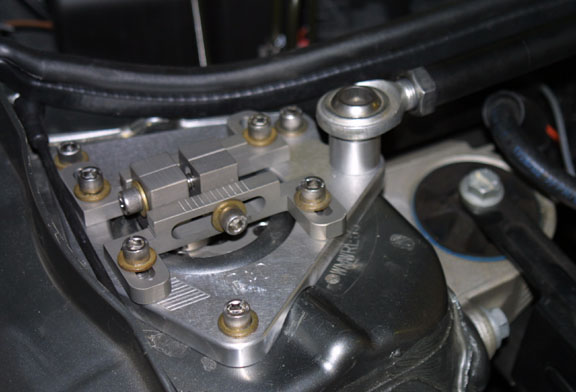

If you modify the triangular profile a bit and add a tapped hole, you could use this style heim-jointed strut bar (the pic show a spacer, later omitted, bewteen the 5/8" heim and the plate).
this was an early version of the now discontinued P&D camber plate
