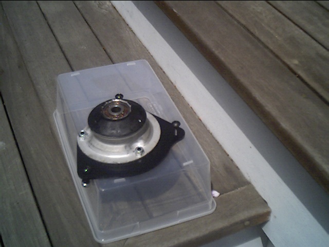

Photos of Ireland Engineering's Fixed Camber Plates
Sorry for the delay - here the photos before the install with new PSS9s...
Cheers
Attached Thumbnails Ireland Engineering "Fixed" Camber plates?-jun20354.jpg   Ireland Engineering "Fixed" Camber plates?-jun20355.jpg

The Ireland plates "raise" the front by 3/16 of an inch...... After 1,500 miles of rough back roads and two DEs, I'm a very happy customer! It would appear that they offer the best of both worlds - street compliance and track performance. No evidence of excessive tire wear yet. I'll keep you posted. BTW, Ireland Engineering's website now has photos posted. If you order a set ask that the mounting bolts be tack welded into place, it will save you alot of agravation.
