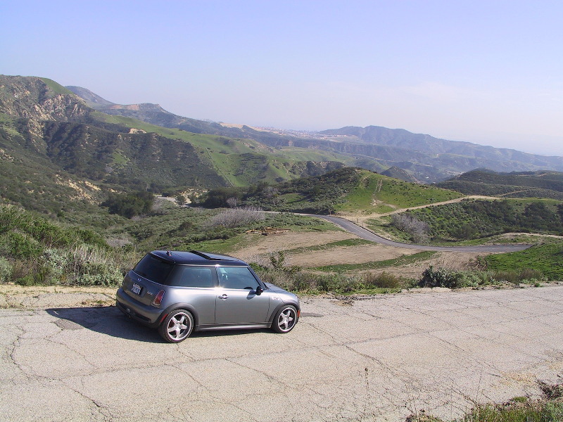

Maxmini,
Which tires/wheels/and suspension do you run when you get the rubbing and on what course do you do the testing- long track with high speed curves or canyon run? I'd like to try it out.
I had made these observations prior to tracking the car on a closed canyon road nearby( see enclosed pic ) which I use for testing. The wheels in question were Hamman 17/8 , 42 offset with 215/45 series tires.I initially had KW coil overs on the car but have since switched to Leda's.
The type of turn that would cause rubbing without a brace or even with the one that didn't work would be either a tight left or right hander with any type of bump or surface irregularity while carving the turn. It really didn't need to be fast but the G load had to be up there. I thought it would be a fact of life that I would rub at the height i was running the car at as it rubbed even with the first bar i tried. It was only after i tried the one from Forge motorsports that i realized I was not rubbing on those turns any more. The same thing was apparent when I tried the Diamond Racing bar as well as the BMP/Pro Mini.
As for tracks my local favorite is Willow Springs and Streets of Willow. Both tracks give the car a good workout at both ends of the spectrum. They don't call big willow " the fastest track in the west " for nothing LOL. The Streets course is exactly what you would think it is more tight with some severe curbing. I would not think to try the car there without the braces as even with them there is a little touch now and then. I hate to think how long the tires would last without them. Hope this helps explain why they work for me .
Randy
M7 Tuning

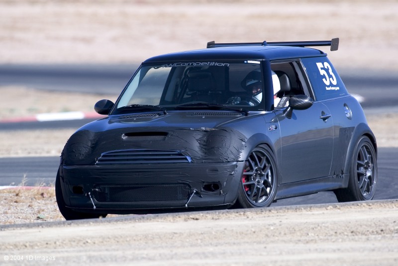

With the clearance I have left on this particular turn I dont think I could afford that milimeter I also have the rear strut tower brace from Pilo and have recently added the additional Convertable front suspension uprights. You can never be too stiff LOL
Randy
M7 Tuning
