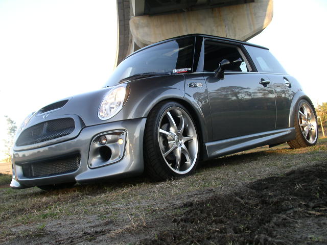

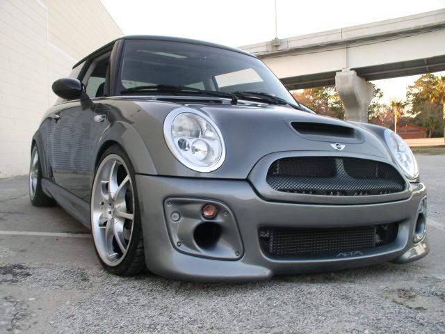

I'm running the H&R's with 18" wheels and I like the just fine + I found them for $899
Attached Thumbnails Ok!  I need help finding the perfect coilover!-club-pictures-016.jpg   Ok!  I need help finding the perfect coilover!-club-pictures-022.jpg
