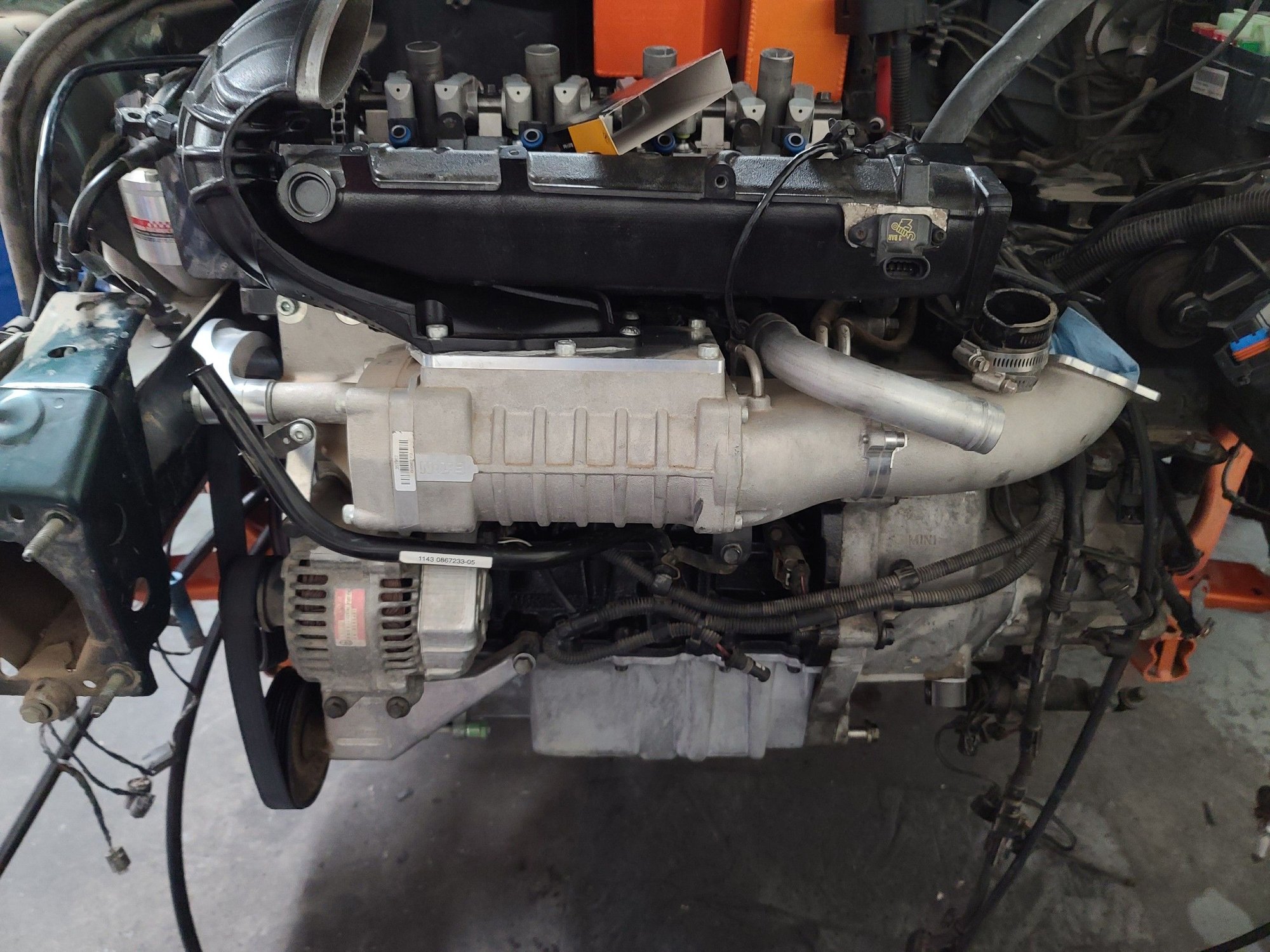

Honestly they are really good for street driving, but figured since I want to have some track days I might want to upgrade. My mini is transforming right now, pulled the old stock motor with a RMW dominator cam and tvs900. An RMW 1.8 stroker with a billet crank, 1000cc injectors, Link ECU and 7” dash display, E85 kit, oil cooler, and 53mm sc pulley, Giken twin plate clutch, Giken LSD, and swapping out the Milltek header from the RMW shorty to match the ported exhaust ports.
