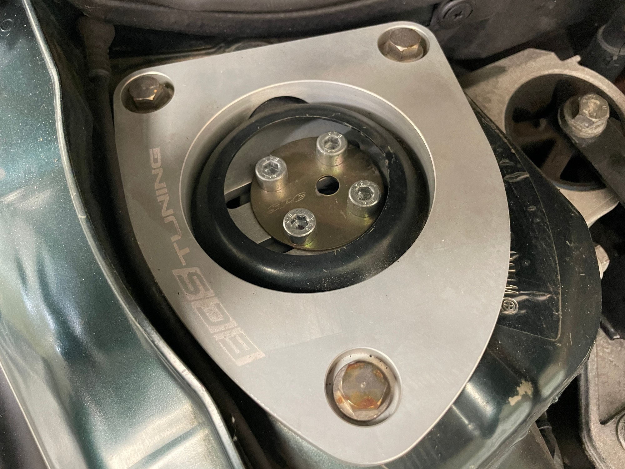

Here are some pics of my current set-up, and my rubbing problem:
KONI + stock springs
KONI Yellow
SPC camber plates - maxed out
Where my stock springs are hitting the firewall/body, limiting camber to -1.3 degrees

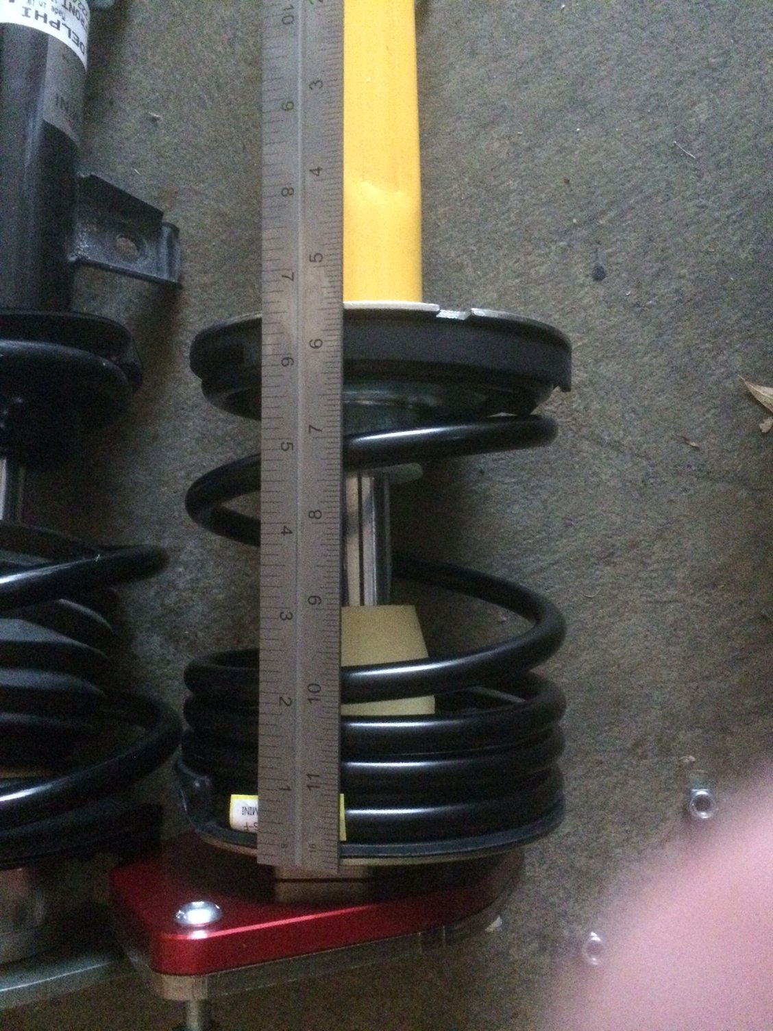

Swift Spec-R springs are straight-wound as well.
edit: Photo here.
Last edited by deepgrey; Jan 9, 2022 at 11:54 AM. Reason: add link to photo of spring comparison

Oh no! I didn’t see your post. I could have taken some quick and dirty measurements when I swapped over to my winter tires. I want to say that they’re pretty much the same diameter most of their length, and that it’s roughly the same as the lower seat. I’m just going off memory (and my eyecrometer) from several years ago though.
In lieu of actual measurements, I had this photo sitting on my iPhone. It’s the wrong dimension, but at least it gives you a bit of reference, however bad it may be. Angles and lens distortion always make measuring from photos a pain.

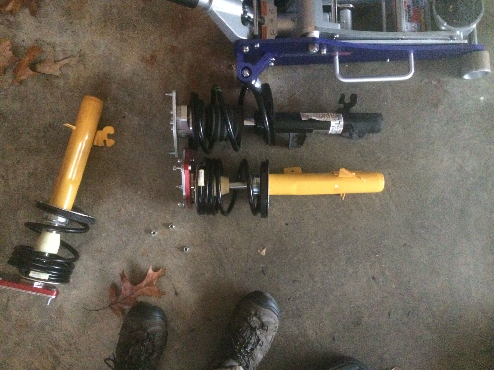

@Aindrid I feel like I take way too many pics of my car, but somehow I struggled to find some good comparison shots between pre- and post-lowering springs!
This is stock springs, empty car.
This is Spec-R springs, empty car.
