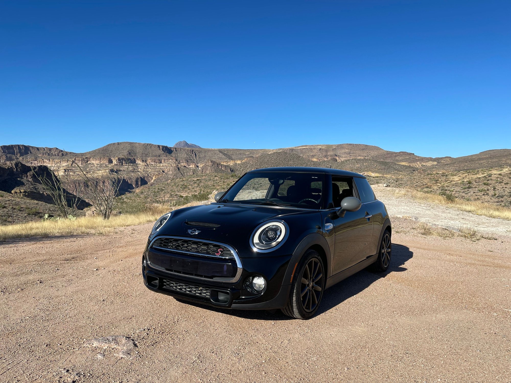

Hello! Fresh into Mini ownership, picked up a beautiful 2017 MCS on Friday. Looking to improve her handling before adding power. Does anyone have any recommendations as to where to start? I’m torn between thicker wheels/ tires, sway bars, and lowering springs. Would keeping the stock 17s, getting better tires and lowering her be a good start? Or would thicker wheels be a better first step? Later on I’ll be adding a Dinan tune and CAI, but handling is definitely where I’ll be starting for now.
Here is Hyena as she sits stock

Welcome! And the Mini looks great!
