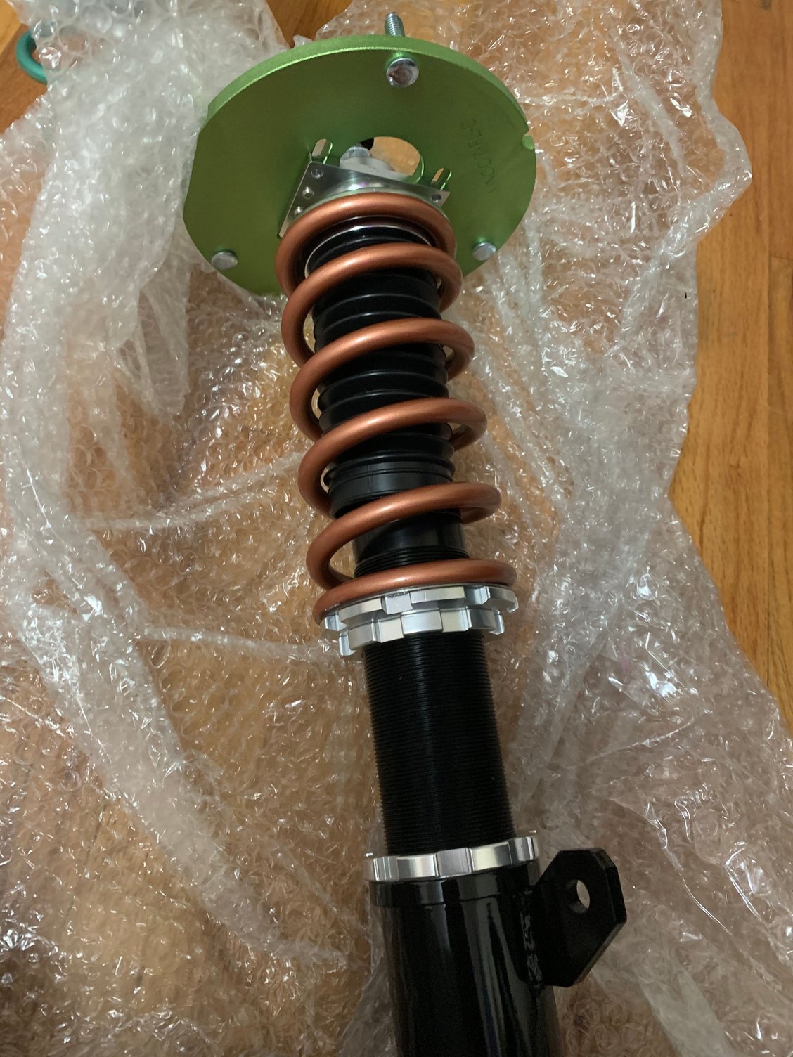

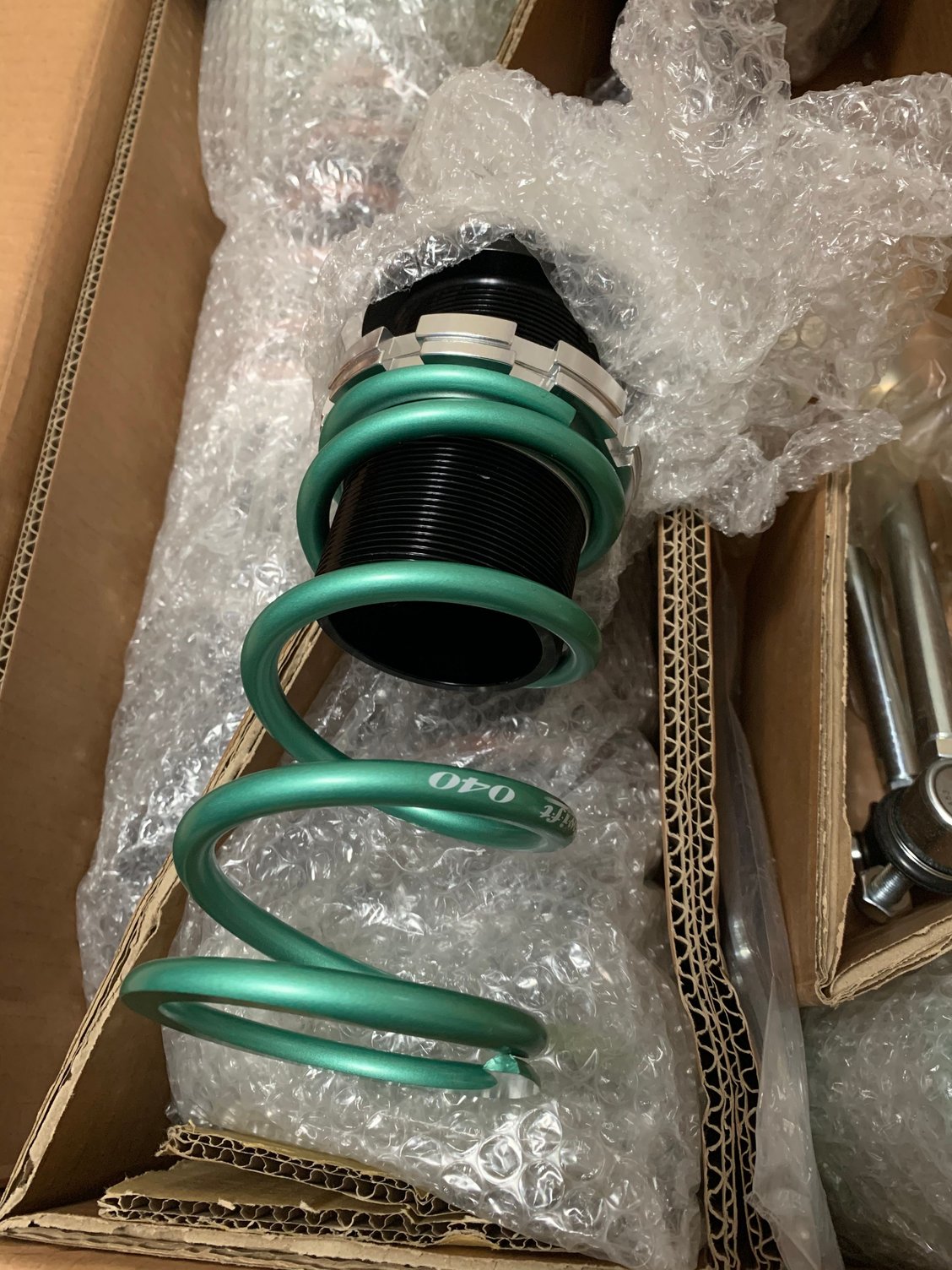

Feal has only ever made 2 sets of coilovers for the F56. I am the owner of set #2.
I have their 441+ with basically all the upgrades go can throw at it. The 442> is overkill for daily use.
keep in mind the entire kit is custom made for your car. That said, they will feel however you want them to feel. I went with a slightly softer damping setup with 5k/4K swift springs. The combination has been amazing thus far. When you dial in the stiffness with the adjusters. The car comes alive. When you dial it back for comfort, the most noticeable difference is the feel of standard springs vs progressive springs.
Their customer service is also unmatched!
