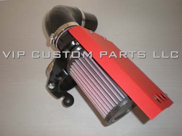

I've got the VIP as well. The biggest difference is that the VIP has a shield on top, which means something extra to remove when looking to service the filter. Not sure if this shield does much, though I like the look of it.

So, does the metal shield on top of the VIP's intake prevents hot air sucked in much? Or you don't really need it, so NM doesnt have it?

I'm not sure what the intent of the shield is actually. it's not that far below the interior of the hood (a metal shield itself), right? it certainly isn't providing a barrier to airflow since air can travel around it easily.
is it possible that it could be a vestige of the mini cooper s with hood scoop? not sure if you'd want to block the air coming from the scoop but maybe the cooper s hatch blows hot turbo air into the filter.

I think it may be a better design as from what I can see it has a flange to hookup the air intake tube coming from the grill. This has to be better since it will bring in fresh air for the outside just like the stock air-box.

One thing to mention, the intake from the grill is still in place for both, but instead of feeding directly into the stock air intake box, it's blowing right into the "area". Making a couple non-educated physics-type guesses, my feeling is that the shield helps regulate a bit of that intake air to keep it near the filter for the intake (again, non-scientific; so no need for flaming if I'm wrong).
From nccoaty's picture, you can see the lower attachment for the external air (from the grill).
