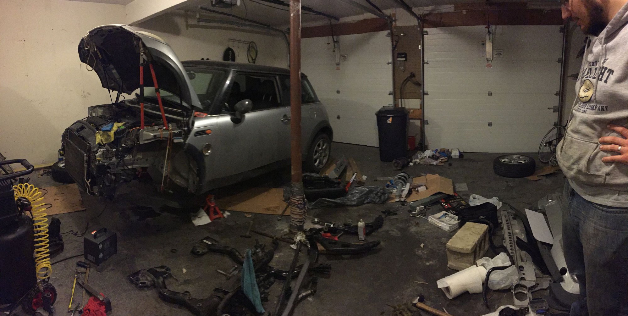

We are stuck because we can’t press the front control arm bushing on to the control arm.
I have work tomorrow so I won’t be able to take new pictures and my wife has to take me to work. 3 hours before her shift.
