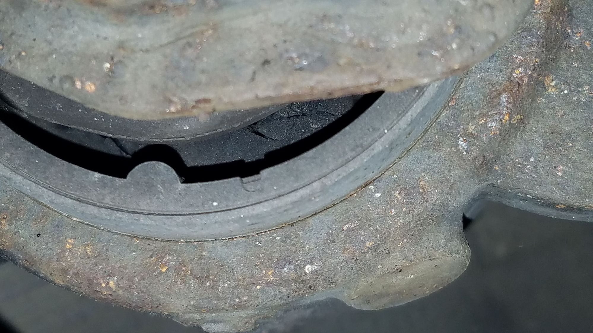

2005 MCS Convertible with 71K miles and original control arm bushings. The rubber is cracked and they look like they’ve leaked (see pics). Will be putting in Poweflex. Looking for input on the cutoff method vs pre-pressed from Way Motor Works. FWIW I have the M7 Under Strut System, not sure if it would interfere with either method.

I have tried the cutoff method, only to be thwarted by not even getting the inner ball joints off. The problem comes from the pickle fork hitting against the frame, thus, not being able to pop the joint. I'm going to try again next weekend with 2 pickle forks to see if that works. I have tons of work I plan on doing next weekend so Scarlet will be in front end Maintenance Mode. Let us know what you decide and how it works our for you?

We've tried all the methods of doing the control arm bushing as we of course are a shop and the faster we can do the job the more profitable it is. I can say that we still have found dropping the subframe in the rear and taking the brackets with the bushings off is the easiest and fastest. Trying to pull the control arms usually damages the ball joints then increases repairs, let along often found stuck ball joints that take way more time to get apart than you want to spend.
