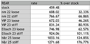

So how about the Eibach on loose setting? Still too stiff for you? Trade me for my VIP "almost 23mm?" =) You could also go to a medium setting by putting one side on stiff and one side loose.
Attached is the XLS file I used. The file has a link to this post. Good info there.
https://forums.nasioc.com/forums/sho....php?t=1279944
Also attached are the results I got with the XLS. The info I used to calculate is all actual measurements that I took from the bars, except the Eibach bars. "Eibach 28h (their specs)" is taken from their own TUV certificate where they list the specs, but it's a little different from the stock geometry. "Eibach 28h (stock specs)" just matches the dimensions I took of the stock bar- don't know which is more accurate. And the rear bar I used the same specs as the VIP bar. Arm length is a little different from the NM, so this is probably off a bit. But pretty safe to say it's going to be stiffer than the VIP, assuming their 23mm really is 23mm.
Oh, and "stock" bars are measurements from my OEM Sports Suspension, which is supposedly heavier bars. Again, would be great info to know the wall thickness of the standard bars.
Attached Thumbnails H&R Sway Bar Kit-sway-bars-front.jpg   H&R Sway Bar Kit-sway-bars-rear.jpg
