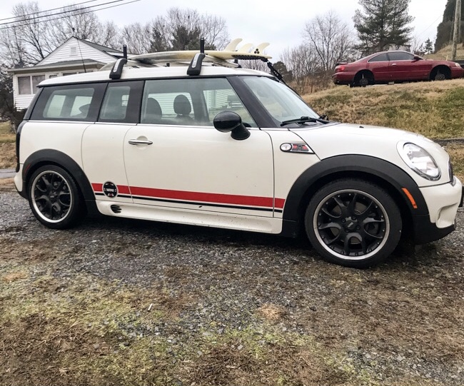

This is my car ... any input on thoughts for wheels/ suspspension would be appreciated.

You will rub the rear fender liner/wheel arch with that width/offset/tire combo on a lowered R55/56.
A slightly lower profile will help reduce some of the rubbing and you'd want to run some camber to avoid further rubbing.
You should be ok with springs but definitely not with coilovers if you're planning to go low.
