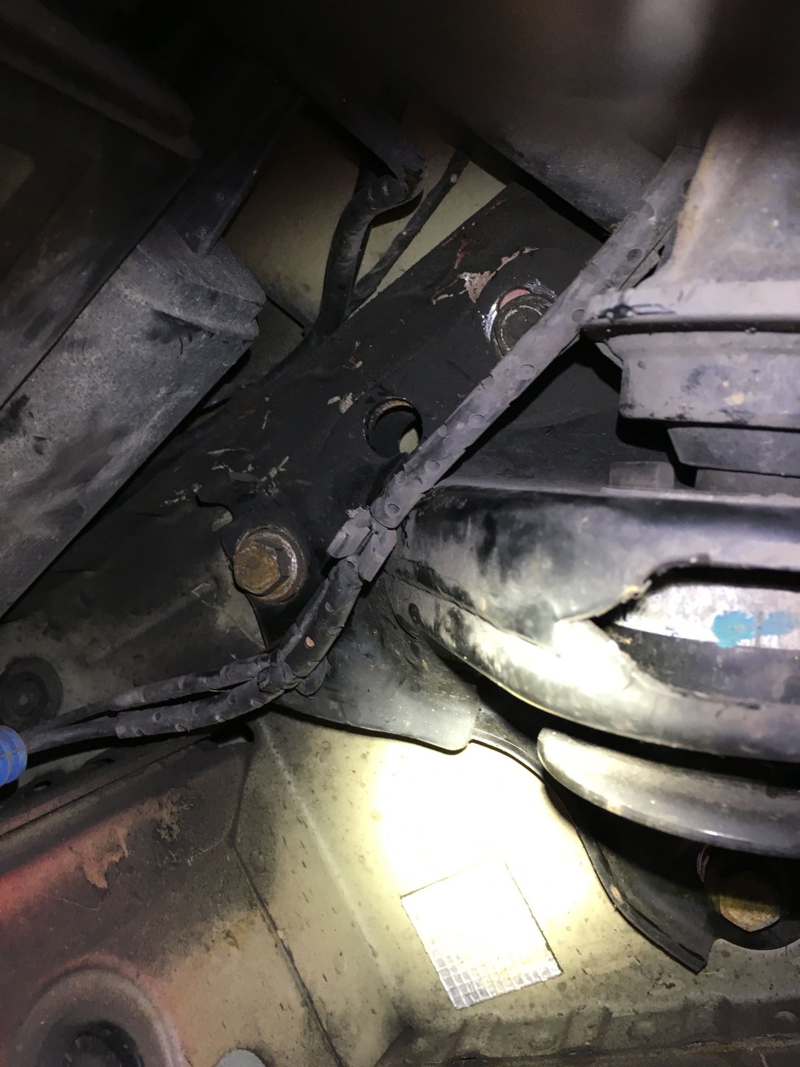

I just picked up a mini and it looks like the owner whacked the right rear wheel pretty good. You can see the bubble on the tire there.. maybe it was a big pothole because the rim inside and out doesnt appear to be damaged. Its misaligned, mainly with toe an camber.
I'm going for an alignment today but was wondering.. it looks pretty bad to me. Can this be adjusted out? If not, what is likely bent, and what will this cost? Maybe I should go aftermarket to save cash? This is a street car, not track so I just want the normal alignment specs (which I cant seem to find anywhere).

When they get it on the alignment rack, the tech should be able to see what, if anything, is bent. If they are a decent shop, the cost should be minimal for diagnosis.

Yes. That does look the PO wracked that wheel pretty good there. Just ignoring the possibility that the wheel is bent and look at what might be damaged on the suspension stand point.
My bet is that both upper and lower control arm links are badly bent. They are quite weak but that can be a good thing in your case as with luck, they sacrificed themselves to save the more expensive suspension parts, and chassis/subframe damage. I am quite sure based on the photos you cannot align the car without either replacing them, or straighten them out. The way BMW construct these arms, they look almost like they are designed with this in mind.
Going to a good alignment shop and they should be able to tell you what are damaged.

wow my rear a arms look totally different.. I have a , maybe thats why.. see this pic..
You can see that there is bad wear on the tires. I think the previous owner fixed the back bumper, and maybe the a arms and drove on it like that for a few thousand miles or something. They dont look totally new, but they dont look bent either, which is surprising because they are just a U shaped channel and seem like a weak point..
This part was the only obviously bent part - hard to tell from the pic but the bolt at the bottom - around that one has lifted from being flat.
So the aftermarket arms may give me enough movement to get it back in line? I'm a little worried because it also looks like the wheel is not only toed back about .5", but pushed in about .5". The clearance from the tire to the fender liner is like 1/8".. it rubbed in a couple places.
The car is at a respected body shop now being looked at. I'll know tomorrow if they can get it perfect..

I think I may have the wrong wishbones on there.. can anyone confirm that? EDIt.. looks like they are just aftermarket.. https://www.ecstuning.com/b-febi-par...326768726~feb/ - so that confirms they have been replaced, at least the lower wishbones. So, presumably, they were obviously bent as well.

I cannot make out clearly the last photo, except to notice the shifted bolt/nut. It is obvious to my devious mind suspecting that the PO attempted to correct the badly misaligned rear wheel unsuccessfully.
Yah, you have JCW parts. I am never a big fan of JCW on the new Mini's. It is all about branding and extra gravy for BMW. Those control arms do not look much better than the standard issued arms on the S. In fact, it looks to me some smart engineer figure out how to save even a few spot weld and to make the arm in one stamped steel piece by folding it. Like I say, in your situation, if I were you I would pray that the control arms are the weak links as otherwise the likely damage done to the trailing arm, or/and the subframe is costly to fix.

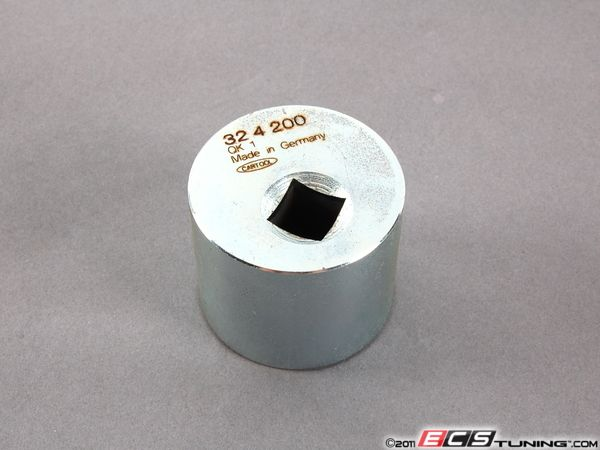

Don't really need the eccentric socket tool to adjust the rear toe,
but it does make it much easier to do, less hit and miss with each adjustment.

Tool
Tool not required, but boy it's so
much less struggle!!

Just an update to see what you guys think.. I replaced the trailing arm mount last night and it was clearly bent when comparing it to the new one. Most of the bend was happening at the base where the frame bolts attach. The rest appeared to be straight.
The changed moved the wheel forward about 1/4", which is good, and I think the camber changed about +1/8" out, which is good. The spring was actually very close to the trailing arm and I could see at one time (likely during the impact, the spring cup hit the arm and left a (now rusty) spot. That distance grew from about 5mm to 10mm away, which I think is pretty close to what the left side looked like. BUT, I still need to come forward about 1/4"-3/8" and out about 1/4".
I've ordered a new trailing arm to see if that helps, but if it doesnt get me back perfect, can you guys suggest what to look at next? I like the adjustable control arm idea, but I have to assume that they are new (and they look straight), so I suppose the only other thing to check is the rear subframe, maybe it was bent where the control arm attach?! I dont think (hope) the actual frame moved much because body lines etc are still ok.

When I first suggest the possibility of subframe damage, I have not check to see the details of the Mini rear suspension. I basically were referring to the possible damage areas:
  1. trailing arm pivot point - which turns out to be bolted to the body with a 3-bolt bracket.
  2. trailing arms - the PO evidently replaced
  3. trailing arm inboard attachment points - subframe bracket
  4. trailing arm itself
Good that the offset improved somewhat after you replaced the trailing arm pivot point bracket (1). I have no reservation that the trailing arm (2) itself is likely bent. We can just hope that the body mounting points for the trailing arm is not distorted. Lastly we can also hope the inboard bracket for the control arms are not distorted, as it is a part of the subframe.
I concur that the next thing to replace is the tailing arm. You should contact one of the Mini partout i-vendor to get a used one. I personally won't spent $300 for a piece of stamped steel thingy.
