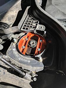

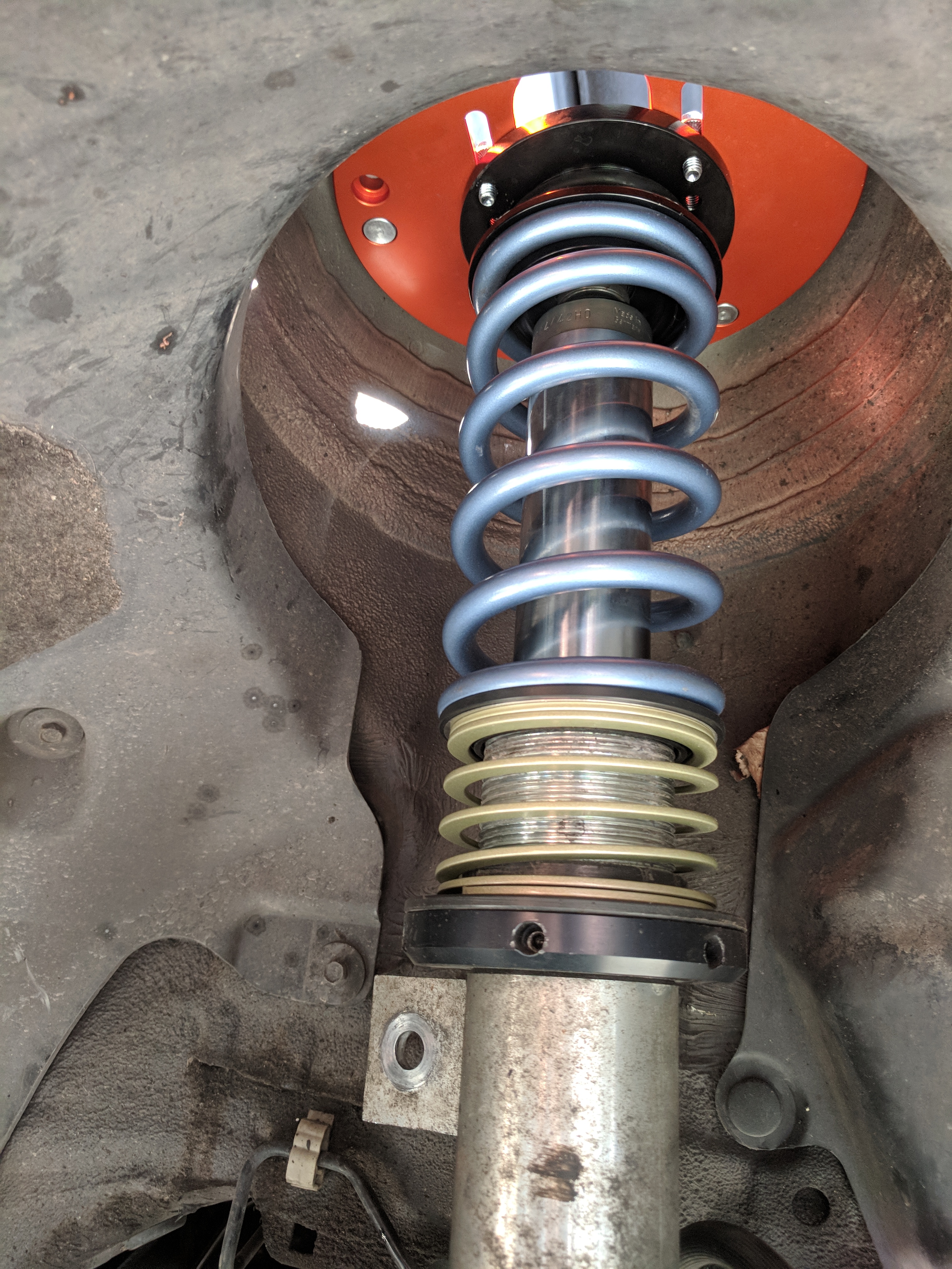

wanted to jump into this thread. after quite a few cycles, i finally got my camber plates installed. in my case, i have Bilstein PSS10's. while the lower part of the coilover is a 60mm ID perch, the upper uses the stock top mounts. this required me to get not just new camber plates, but also new coilover springs. if those with the jcw coilover kit can confirm their springs are 60MM inner diameter, this will work!
the parts i got were:
Camber Plates: AST Camber Plates
Springs: Rear 6" Swift springs
Springs: Front 6" Swift springs with Swift 4.5" helper springs
i *needed* the helper springs because with the 6" swift springs, when i jacked the car up, they were flopping around with about 2" of space. this caused the camber plate pieces to separate, which concerned me whenever i lowered the car. to those that don't know, helper springs have literally only ONE JOB; to hold up the springs/camber plates in place when the car is in the air. uncompressed the helper springs were 4.5". when compressed, they dropped down to 0.7". this meant that i had to lower my front spring perch another 0.7" to go back to my expected height. at the end, i have the coilover spring perch all the way down to the bottom and the car luckily sits at a good height.
ultimately, while i'm happy, i will say this. if given the option, i would MUCH MUCh rather buy a coilover kit that has camber plates installed. i spent quite a bit of time (and money) putting together this frankenstein kit. for the cost of the camber plates, the springs, and the headache it took to get here, it's worth to pay extra and get a kit that already includes camber plates.
Pictures: the attached pictures will show the following
1) the front bilstein setup with swift main and helper springs
2) the camber plates when installed. i ended up with -2.0 camber in the front after my alignment.
3) picture of the car as it sits today. on the bilsteins and with my spring options, this is the absolute lowest i can go. for all intents and purposes, i'm actually fine with this and quite happy.
the ride is a bit rougher than with the original bilstein springs. then again, these are swift race springs, so i'd imagine they're a bit stiffer.
fwiw, AST sells a coilover solution for the F56 and while they don't come with camber plates, you can add them and they mount right in.
P.S. if you do go this route, please make sure that the bolt you get for the camber plates matches the thread on the strut you are using. i had received M12x1.25 but my bilsteins were M12x1.5. they still owe me the nuts but i temporarily had the nuts rethreaded to match.
