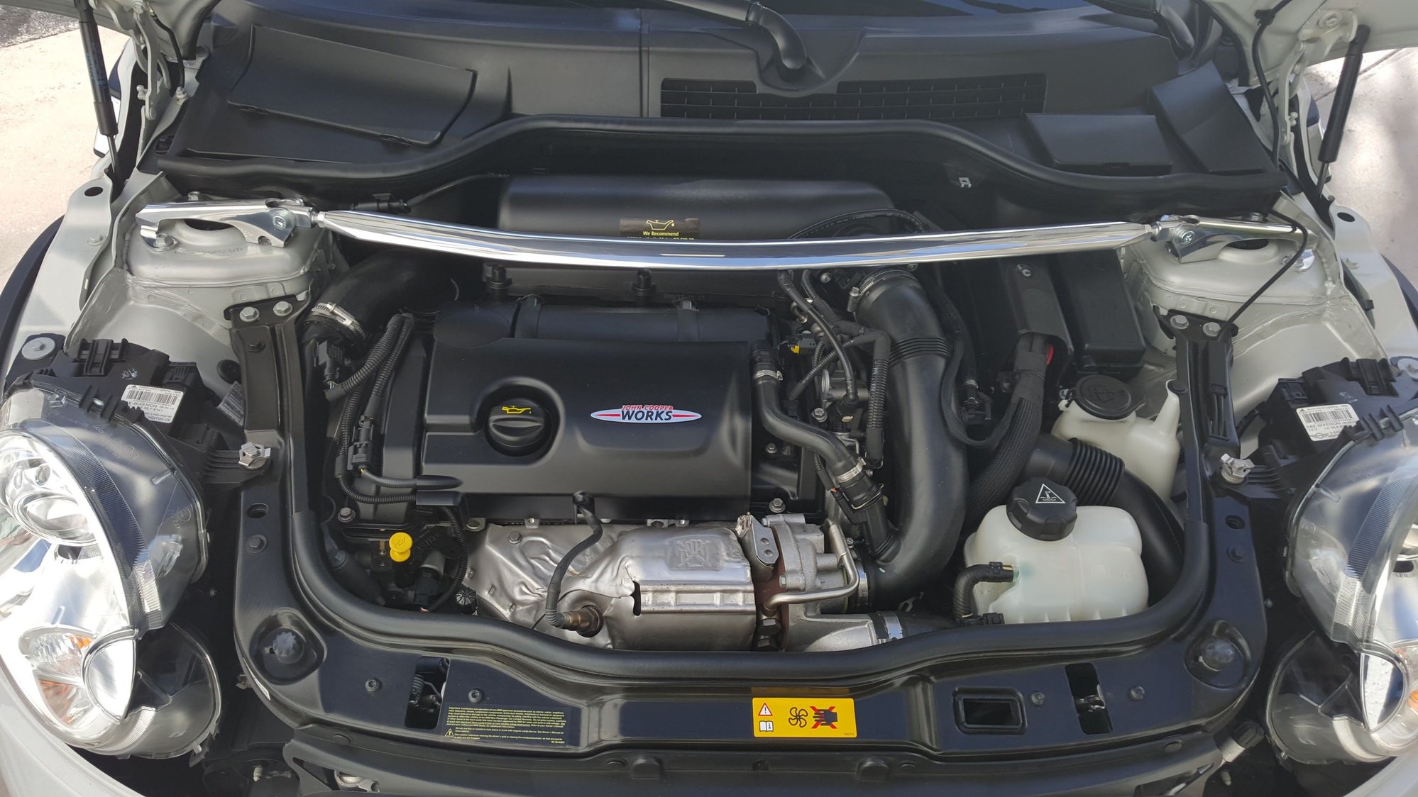

Strut Brace Update
Picked up the JCW front Strut Brace today, Installed it in about 10 min no issues on R58 Coupe JCW.
There is a Brake vent that is touching the strut brace but it's double insulted and I added some rubber insulating tape to protect it.
Handling is actually slightly different turn in is more direct and chassis is a bit firmer.
Ian

Thanks for the update looks great in the bay. And the feedback. I like mine.
