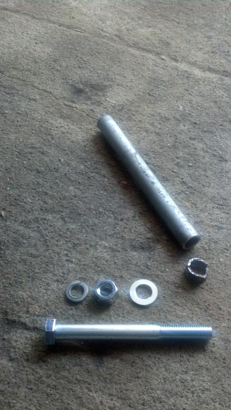

I did not drill the arms, just adopted a longer class 10.9 M14 bolt (120mm or ~5.5" long), with a custom washer on the outboard side, and standard flat and lock washers on the inboard side.
The rear trailing arm is cast out of aluminum, and you need a washer on the outboard side else the bolt will cut into the trailing arm as you torque it to the stock 122 ft.lbs.
The outboard side is not flat, with the top of the trailing arm cast slanting upward. I found a thick gas pipe with roughly 1/2" internal diameter, cut off about 10mm wide piece of it for a washer, then cut a ~5mm indent into 1/6ths of its side to go over that trailing arm indent. It was less than perfect fit, but good enough to keep the bolt from bending, and allowed me to torque it to the stock 122 ft.lbs.

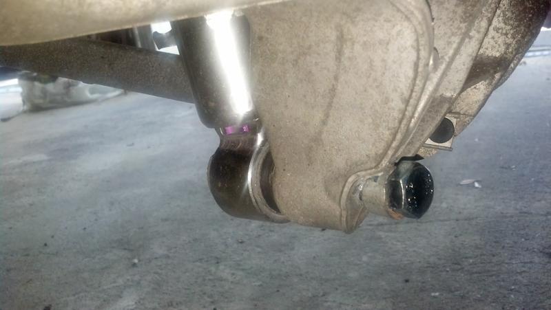

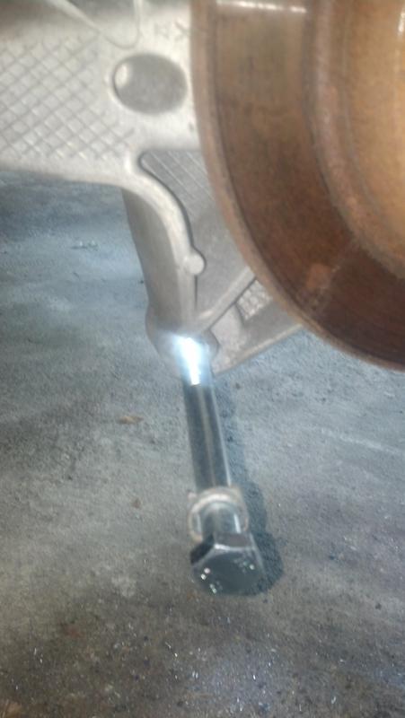

Enclosed are the pics, as promised.
Fits and works like a charm.
Pic 1 shows the parts, and a piece of thick pipe I used to fashion a washer to fit over outboard trailing arm angle. You can do w/out this slotted washer, but then you are likely to bend the bolt's head or cut into the aluminum trailing arm.
I inserted the bolt from out-board towards the center line of the car.
That way you can bolt/un-bolt the strut easily in the future.
Please note - you need grade 10.9 bolts, not just something out of an average hardware store. Grade 5 stuff in Home Depot may break from torquing to factory 122 ft.lbs, or from sheering forces exerted on the bolt.
