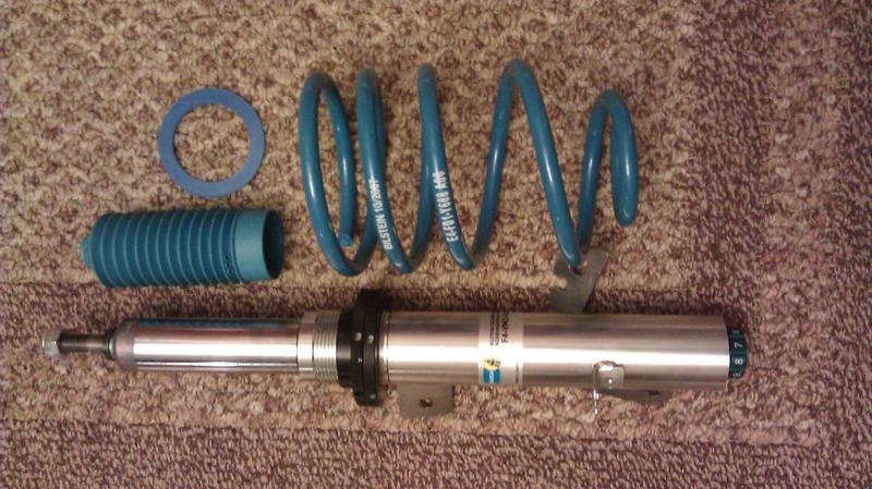

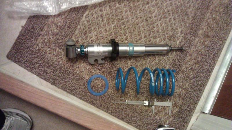

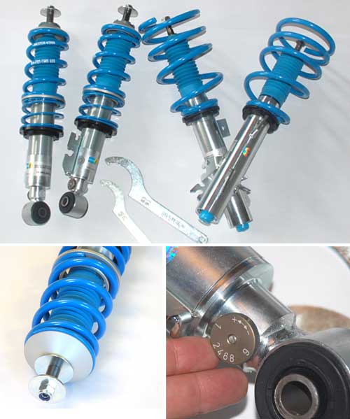

Have been thinking of modifying a set of PSS10 for the R56. These are not the same as the PSS9 for the R53:
Both front and rear springs are progressive and the internal diameter of the lower part of the spring is 60 mm. From other threads I gather the PSS9 is 2.5 inch ID, and the rears are linear.
Front would be easy: Vorshlag plates with a 60 mm hat and a 60 mm ID linear Hyperco Spring, probably in the 6 inch length.
Rear is problematic, as it uses the 85 mm ID (stock diameter) at the top of the spring, which mates to the 85 mm stock top hat....
What would be the work around for the rear springs?? Not sure it is possible without a 60 mm hat? Is there some type of rear top hat conversion kit out there?
PSS10 front and rear pics below, along with PSS9 example:

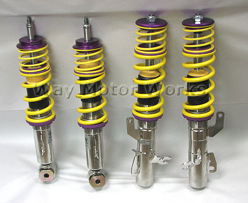

Looks like they use custom 60 mm top hats, scroll to last page:
http://docs.kwsuspension.de/eah68620070.pdf
Probably could work? But the guinea pig factor gets larger, might have to just wait 3-5 months for some AST's
