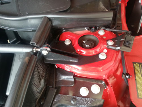

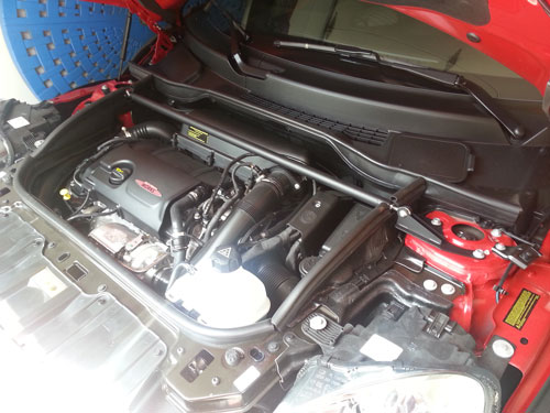

here are a couple of awful camera pix, but it's what I had at hand!
Certainly nothing fancy.
As far as track quantifiable. I assume it must be since a lot of the high end track and supercars have them(Ford GT, Viper, ZR1, etc), but certainly I don't know that it would add much increased stability in track conditions without other upgrades in place as well, you know?
I will certainly post my feelings about the 22mm rear ASB once I get it installed.
Jeff

Old Aug 11, 2013 | 12:41 PM
Braminator's Avatar
Braminator
Posts: 7,242
Likes: 55
From: Wherever she takes me.
Looks great. Good luck. Now go motor on!
